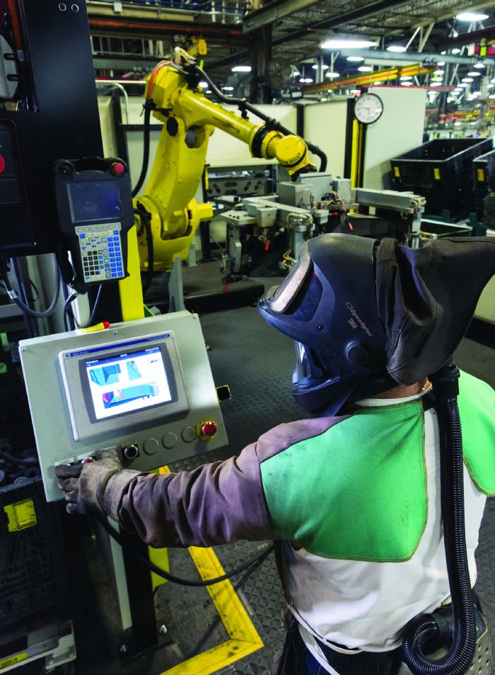

John Deere’s Will Chemin, tech lead for welding and fabrication for the firms’ Construction & Forestry Division, notes that Deere has been using touch sensing for part ID for several years. What is new is the use of the part-ID data within the MRP system. This prevents errors when reporting production, and automatically updates inventory figures through the MES system. The reporting data also route through to inventory and relieve the child materials present in each weldment. The automated updating of inventory then triggers automated purchasing of outsourced components or drives production orders for parts and assemblies manufactured inhouse.
All of this adds up to improved consistency from the firm’s robotic-welding cells, reduced rework and improved inventory accuracy. “Operator productivity is up,” Chemin adds, “as our operators now perform more value-added work, rather than spending nonvalue-added time on completing reports.”
