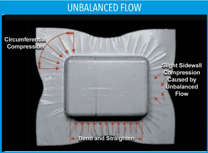

Dissecting A Square Shape
Unbalanced flowRather than look at a drawn square or rectangular part as a whole, dissect it into straight lines and corners. Essentially, a square or rectangular drawn part with radial corners can be dissected into four quadrants of a round drawn part connected by four straight lines. Because the corners have a curved radial profile, the sheet metal is in radial compression. That explains why far less material flows in the corners than in the side walls. The side walls offer very little resistance to flow because very little or no compression takes place; the sheet metal flows in more on the sides than in the corners. (Fig. 1).
Balancing Metal Flow Values

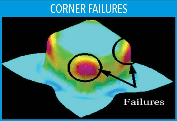

Corner FailuresIf an insufficient amount of sheet metal flows into the corners of the box, it may result in excessive thinning, necking or splitting. (Fig. 2). Too much material flowing into the side walls may result in loose sheet metal, curvature of the sidewalls or an effect referred to as “oil canning.”
To reduce the possibility of thinning, necking or splitting in the corners, one solution involves changing the limiting draw ratio. Because the punch geometry cannot be changed, the only alternative is to cut or miter the blank’s corners. This changes the punch-to-blank relationship—not by increasing the punch size but by decreasing the size of the blank’s corners. Mitering the corners is a common method to increase material-flow values in the corners (Fig. 3). In addition, increasing the die-entry radius size can help promote material flow in the corners.

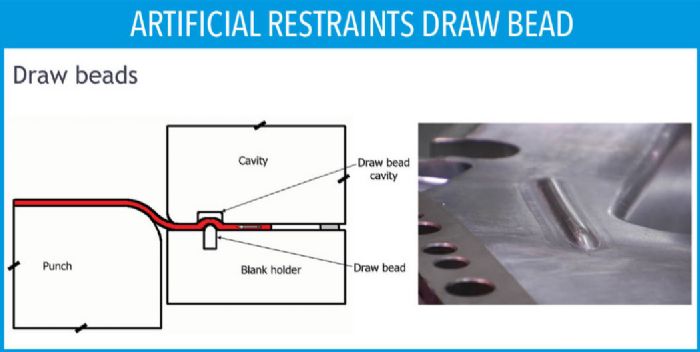

Artificial restraints draw beadIn the side wall with no flow resistance, it often is necessary to add what is called an artificial restraint, defined as anything added to the draw pad or outside of the part to help reduce or stop the amount of material flowing inward. A draw bead represents a very common type of artificial restraint. Natural restraints are a product of the part design. For example, a corner profile radius in a rectangular drawn part naturally causes some resistance to flow because of compression created by the feature. Draw beads create a restraining force by causing the material to bend and unbend prior to coming into the cavity or over the punch (Fig. 3).
The severity of bending and unbending along with frictional values determine the restraining force. The depth of the draw bead, the radius on the draw bead and the radii in the draw-bead cavity all control the amount of material flow inward. The part’s corner has a natural restraint, but the side walls require an artificial restraint. This explains why draw beads often are located on the straight wall of a deep-drawn part, whereas a draw bead rarely is found on a very deep corner profile.

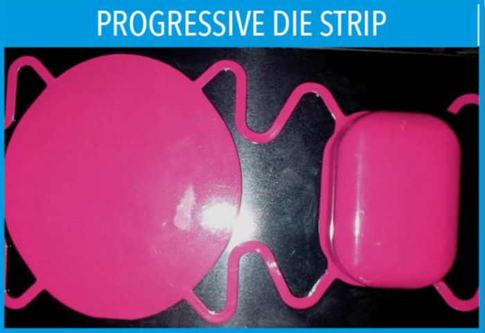

Progressive die stripKeep in mind that as the corner profile radius of the rectangular shell increases, the depth of forming that can be achieved in a single operation also increases. As the profile radius increases, the amount of compression occurring in the corners reduces. Compression creates the resistance to flow; subsequently, reducing the compression increases the amount of flow. For instance, a rectangular box with a 1-in. corner profile radius can be drawn considerably deeper than the same box with a 0.25-in. profile radius.
In addition, always try to use the smallest blank possible when deep drawing (Fig. 4)—especially important in areas where the material is in compression.
