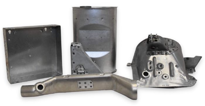

A-galvanized steel partsPresented are different perspectives:
  1. What happens if shops RSW coated steel as they would bare steel?
  2. What happens when the welding process allows removal of the coating out from under the welding electrodes?
Increased use of galvanized/coated steels has elevated concerns about their weldability and attainable weld quality. Shops can spot weld through most metallic coatings, although with varying degrees of success depending on the coating composition and thickness, and the welding process used. If the process calls for keeping the coating underneath the areas of each weld, the welding parameters must be adjusted to compensate. Those adjustments depend on how the coating affects contact resistance; the allowable amount of electrode marking; and the tendency of the coating to alloy with the electrodes.

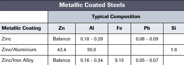

The coatings under consideration (see the accompanying table):
  1. Zinc—Referred to as hot-dipped galvanized (HDG), this coating has the appearance of a fine spangle that results when the coating solidifies.
  2. Zinc-aluminum—or an aluminized coating (Al-45Zn).
  3. Zinc-iron—Referred to as galvanneal, this coating has a smooth, dull, matte-gray finish.
Resistance-Welding-TableNo other coatings will be discussed here due to the vast array of coating combinations available.

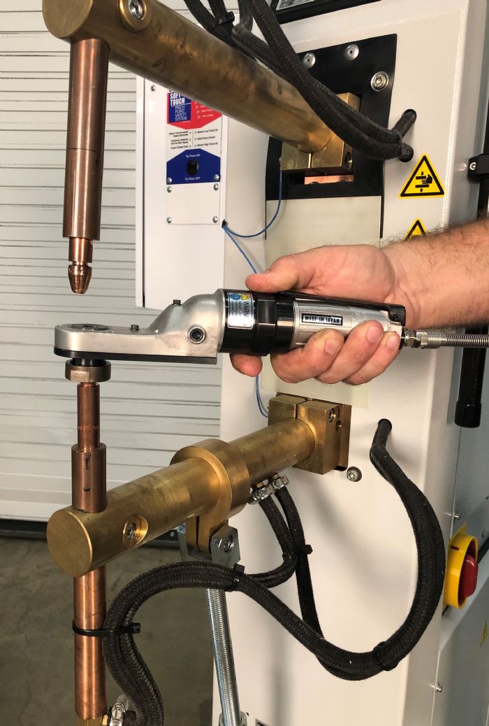

Well-Dressed Tips
Proper tip dressing will pay huge dividends when welding coated steels. Establish a routine of dressing tips on a regular schedule and do it well before weld failures occur. Tip-dressing tools vary from a radiused hand file (not the optimum method) to a motorized dresser equipped with cutter blades selected to match the electrode’s desired weld face. Fabricators can dress the tips while they’re still installed on the RSW machine or remove the tips and dress them in a drill press or lathe.
After dressing the tips, or installing new ones, make a few welds on a scrap piece of the same material as the workpiece, to season the tip faces. Then use a Scotch Brite pad to buff the weld faces, leaving a stable coating of zinc. At this point, it’s best to leave the zinc on the tip faces alone and only remove the mushroomed portion during subsequent dressings.
Note: The brass-like appearance of the weld nuggets is good. If the weld face starts to stick, immediately redress or replace the tips and season them again.
