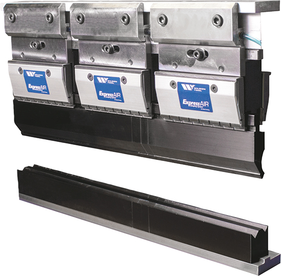

Designed by Wilson Tool, the new Express Air clamping system clamps and seats front and back tools simultaneously using a single pushbutton remote. This quick-change technology has helped Pinnacle Precision reduce setup time by eliminating the need to hand-tighten set screws and manually seat the punches.
“We probably perform about five to 15 setups per day, depending on the batch size,” McLaughlin says. “Using the air-powered clamps is a huge timesaver. The system clamps, seats and releases the punches all at once, which dramatically cuts our setup time.”
Powered by standard shop air at 90-120 psi, the clamping system also allows operators to set up gaps between punch holders to create an ideal setup for box bending.
“With other clamping systems, the clamping bed takes up inches of travel that you just can’t get back,” says McLaughlin. “With the air-powered system, since we can create spaces between the punch holders, we can bend deeper boxes and still have the power that’s not found on manual systems.”
