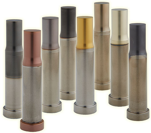

When a basic coating fails to provide sufficient results, however, metalformers can move to a harder coating. For piercing, blanking and forming applications in particular, coatings with a hardness of 2900 to 4000 HV are ideal. The coefficient of friction for these coatings should be between 0.3 and 0.6 for maximum results.
Tool coatings for these types of applications include proprietary coatings available from tooling manufacturers, as well as TiCrN and TiZrN. While all of these coatings result in increased wear resistance, improved surface finish and added toughness, many proprietary options and TiCrN are particularly helpful in reducing galling.
Many stamping operations involve high-impact, high-heat or high-pressure applications, all of which create significant stress on the tooling. For high-impact applications, AlCrN is the ideal choice except when working with aluminum materials. When working in high-heat applications, TiAlN and AlTiN give metalformers exceptionally hard coatings that perform best when working with stainless, high-strength or ultra-high strength steel. As an added benefit of stamping at high surface temperatures, aluminum oxide forms on the tool, which enhances coating performance. Here again, stamping aluminum with these coatings is not recommended.

Many proprietary coating options are designed for aluminum and other soft materials, such as mild and galvanized steel, while other coating options for producing aluminum parts ideally are suited for use on materials prone to galling. Additional tool-coating choices when working with aluminum include TiZrN, which is adept at helping create parts made of other nonferrous materials, such as copper and brass. Coatings that do not enhance production when working with aluminum include AlCrN, TiAlN and AlTiN.
Stainless, high-strength and ultra-high strength steels normally experience the best results using TiAlN and AlTiN coatings, especially in high-heat applications. When using these types of coatings, an aluminum oxide forms, which helps enhance performance. For HSLA steels, proprietary multilayer nanocoatings perform well under high-pressure applications for punching and forming.
