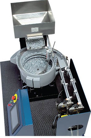

Options Abound for In-Die Fastener Feeding PennEngineering provides two standard designs of PEMserter in-die feed carts: one for use with PEM FH, HFH and HFE studs; and the other for PEM S nuts. Both carts feature as many as four feed lines and both are adjustable to suit fasteners with M5, M6 or M8 thread sizes. These flexible designs enable metalformers to use the feed carts for multiple applications, thus minimizing additional investments on future projects, according to company officials. PennEngineering also offers customized PEM feed carts. Designs allow for single or dual bowl carts (pictured) and as many as five feed lines per cart. Multiple carts can be integrated with a die to accommodate more points of installation or a range of fastener types or sizes. |
