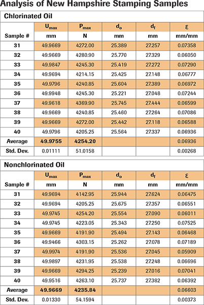

analysis of New Hampshire Stamping samplesThat’s exactly what Steve Costain of New Hampshire Stamping (NHS), Goffstown, NH, did when, in June 2013, he contacted International Chemical Company (ICC).

Following a battery of tests, an analysis was made available to NHS for review as summarized in the accompanying two tables (see Analysis of New Hampshire Stamping Samples).
The two primary data points, Umax and Pmax, denote the depth of the draw and the applied pressure, respectively. The data show that ICC 2801-DL and the chlorinated lubricant perform the same. In many cases, it is difficult to replace chlorinated products with those that are nonchlorinated, but this analysis demonstrates that ICC 2801-DL is a viable alternative.
Costain studied the data and determined that NHS would like to begin utilizing the nonchlorinated alternative. He also requested that ICC perform occasional testing of used lubricant to ensure that the formulation does not break down during manufacturing, or degrade via the drum-top filtering process that NHS had recently installed in an effort to reduce lubricant consumption and disposal costs. Subsequent testing has revealed no degradation of ICC 2801-DL.
