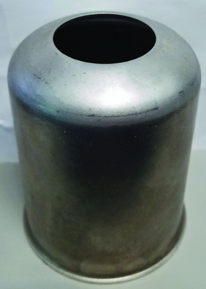

Cups are drawn of material to 0.110 in. thick, with a maximum draw depth of 3.875 in. and cup diameter to 2.5 in. The work accounts for some 50% of the press’s production capacity.

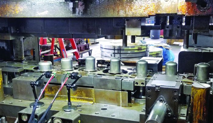

unist-smart-flow-control-armstrong“The multistep deep draw generates a lot of heat,” says Sikorski. “Prior to reaching out to Impact Fluids, we were using an old roller-application system to apply oil to the material, and we struggled to get an even coating. And, downstream in the process along the 72-in.-long progressive die, the spray nozzles over-applied lubricant and created a mess. The process, running at 22-25 strokes/min., was quite challenging to anyone near the press.”

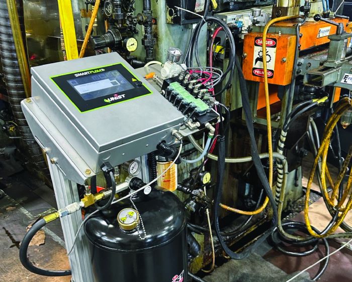

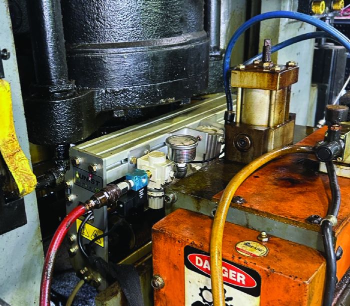

Unist-uni-roll-armstrongThe solution: a new oil-application system that includes a Unist Uni-Roller stock lubricator with 12-in. rollers, and SmartFlow controller, supplemented with four downstream Unist air-assisted low-volume spray nozzles.
“The system applies a very uniform amount of fluid across the entire width of the stock, top and bottom,” Hoff shares. “The spray nozzles (two per side) then apply a small and precisely controlled amount of fluid downstream, in the middle of the deep-draw process, for additional lubrication. The air and fluid volumes are controlled independently by precision needle valves that allow the fine-tuning of the spray to Armstrong’s specific needs. And, an integral valve at the nozzle tip enables quick-acting on-off control that eliminates lag and prevents messy fluid drips. The entire lubrication recipe is programmable and stored with the job number via the SmartFlow control.”
The results: “Reduced waste and fluid use, while improving efficiency, safety and tool life,” says Sikorski. “We’ve seen a 60% reduction in overall fluid use, and significantly reduced oil mist in the air and lubricant on the floor. In addition, the uniform coating of oil on the top and bottom of the stock has improved tool life by as much as 30%, particularly the post and draw ring.
“Parts washing also has improved,” he adds. “We don’t have to change the water as often on our rotary washer, and we’re using 20% less soap.”
Lastly, Impact Fluids replaced the old 5-gal. oil tank at Armstrong with a Unist 15-gal. ASME-rated pressure tank. Says Sikorski: “With the larger tank and the 60% reduction in fluid use, the press operator, who used to have to fill the reservoir three to five times per day, now only does so once every two to three days. That’s helped improve press uptime.” MF
