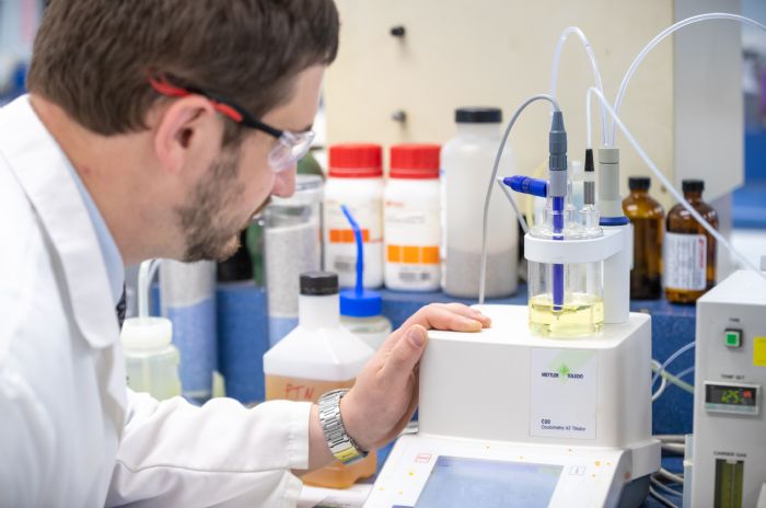

Often the goal is to illustrate how a higher-performing lube can improve efficiency and extend the operating life of the hydraulic fluid, thereby extending the period between drains. Metal formers would be wise to perform frequent and detailed oil analyses, Dinwiddie and Vicars say, to validate oil condition, and use the information to reduce equipment operating temperature, reduce energy consumption and save labor hours related to equipment maintenance. One overriding goal: Extend drain intervals for as long as possible.
“It’s a lot more time-consuming to change machine oil every 6 months over a 3-yr. period, for example,” Vicars says, “than to change it once every 3 years based on oil analysis from samples pulled every 6 months to validate the lubricant’s condition.”

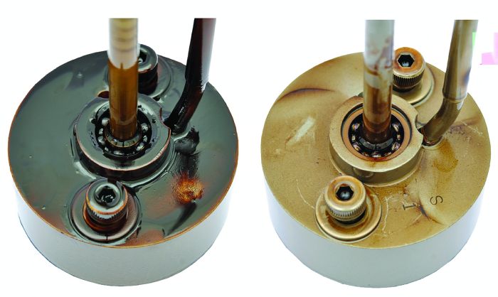

“Varnish,” Dinwiddie offers. “This is particularly true with servo valves, which must not have any varnish on them in order to continue to operate as designed. Varnish—or oxidized oil—may form only very lightly yet can cause a servo valve to stick or otherwise not function properly. This can lead to poor die-cushion performance, premature die wear and poor part quality. And, consider the cushion on the lead press of a tandem line—varnish on the servos can lead to a poor-quality initial part from the first press and ruin the die. When the bad part exits the last press, the maintenance team may spend considerable time troubleshooting the problem.”
The best way to avoid varnish on servo valves and on other machine components requiring lubrication? “A higher-quality hydraulic oil will not produce varnish,” Dinwiddie says, “and it’s important to use a prefilter in the hydraulic circuit.”
“We encourage manufacturers to look at lubricant as being a component of the equipment,” Vicars explains, “and to invest in frequent and deep-dive oil-analysis exercises. A deep-dive oil analysis can help identify whether a facility needs to upgrade its filter system or implement an improved process for avoiding varnish, including switching to an oil fortified with anti-varnish technology.”
