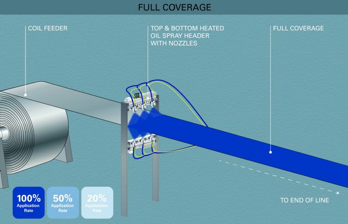

Precisely controlled spray systems, say Day and Scully, enable application of lubricant when and where it’s needed on a blank or coil, and help to ensure that the lubricant doesn’t go where it’s not needed. “Stampers increasingly want to vary the application rate and spray pattern, depending on the size and complexity of the blanks,” says Scully, “and want to spray the right amount of lube in the right locations. This minimizes consumption and improves system performance and part quality. Too much lubricant on any one area of a blank can create parts with cosmetic issues—rippling or hydraulic marks on the material, for example. And, insufficient lube can lead to tears.”
Airless Spraying with Hydraulic Nozzles
Spraying Systems Zone ControlDay and Scully report instances where converting to airless spray systems can cut lubricant use in half, not only reducing costs for the lube and for cleanup of overspray, but also avoiding damage to the press and other nearby equipment as excess oil mist infiltrates machine bearings and other components.
One potentially overlooked variable in the lubricant-application formula is the stamping environment—in particular the temperature and humidity at the press. Day and Scully, both engineers working to support every customer’s unique projects, work backward from the application specifics and the process variables involved to help devise optimized lubrication systems and their individual components.
“We might, for example, be working with a stamper that’s mopping lubricant onto blanks, or overspraying with an air-over-oil setup,” says Day. “So, we might be selecting anywhere from a simple nozzle header to air-atomizing nozzles, or to completely airless hydraulic nozzles. And, when it comes to managing fluctuations in heat and humidity, we typically recommend a heated airless system that consistently preheats the lubricant to within a specified range. This critical, yet often overlooked, step makes lubricant viscosity a fixed and known constant regardless of the pressroom environment, rather than a variable parameter.”
“We used to hear stampers say that when the temperature drops during winter months and the lubricant becomes more viscous, we just crank up the air pressure,” adds Scully. “But today air-assist is almost a last resort. While many stampers now understand the benefits of heating their lubricant to a constant temperature regardless of the pressroom environment, we feel as if more stampers should be doing this…we recommend it more than it is done in practice.”
