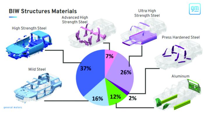

“We have a double shear-plate design that ties together the different compartments of the vehicle,” says Stephen Dissler Jr., GM design release engineer. “An upper shear structure connects the front compartment to the center compartment to the rear compartment. Then we use a similar strategy for the lower end. All of that wraps around the integral center part of the vehicle.”

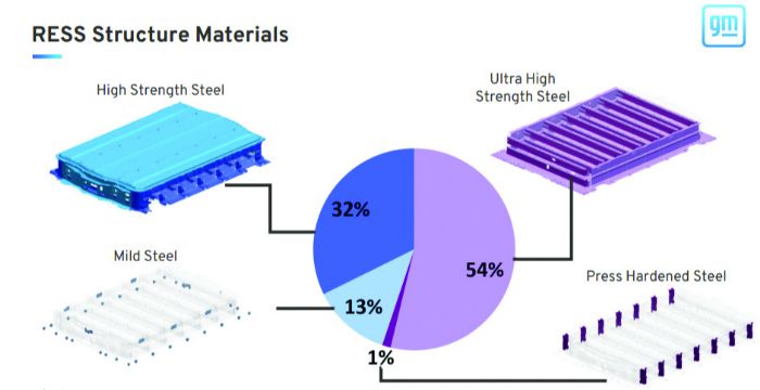

The structural sandwich and other strategies act to hold and protect the battery compartment and RESS.
“For protection, we did a lot with the front compartment, rear compartment and the side rocker area,” Dissler Jr. says. “In addition, the RESS is more than just a battery enclosure. It’s actually a structural member, featuring a lot of UHSS that also protects the RESS components.”
The unique three-box layout, with the large battery area, precludes carrying of a traditional load path, according to James Veal Jr., GM project design engineer.
“The sandwich structure allows us to work around the battery as the big anchor in the middle of the structure,” he says. “We can work the loads around the battery front, rear and side-to-side, and carry loads above and below the battery.”

“Very early on we worked hand in hand with the steel suppliers to learn what materials were out there and what was coming,” he continues. “We worked together to bring in materials in the available timeframe and push the envelope of what we needed in terms of strength or gauge, to place the right materials in the right spots. Then we did a good job of optimizing material usage.”

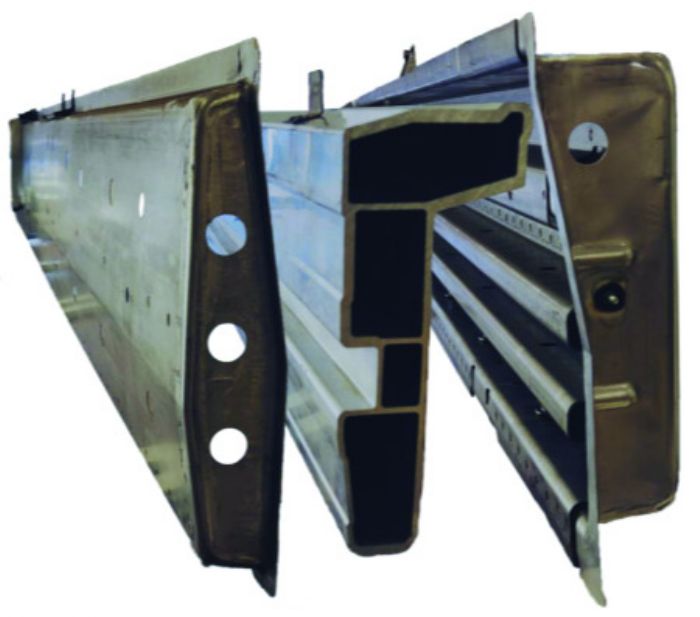

Rollforming challenges and wins by Shape Corp. were outlined during the GDIS presentation by David Seiter, the company’s global engineering leader. Shape Corp.’s contributions to the Hummer project included supply of rocker subsystem parts and other structural components, utilizing rollformers for steel applications and extrusion for aluminum components. In extruding a rocker insert, of 6000-series aluminum, the company had to deal with a large, multi-void hollow part (Fig. 3). Ultimately, Shape Corp. involved multiple company locations and processes and employed an equipment strategy that would scale with the Hummer-program launch curve.
