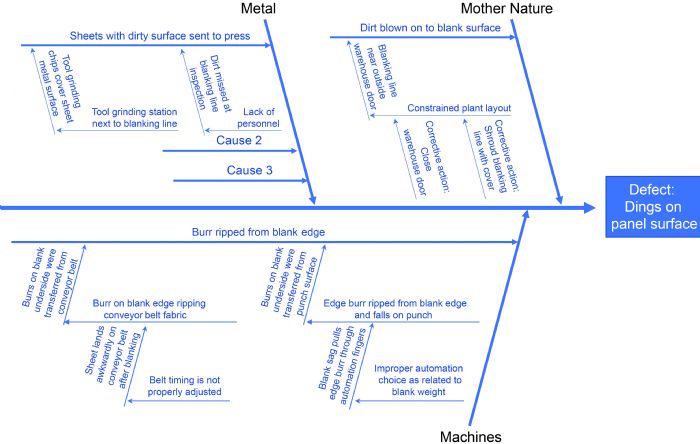

Create a Fishbone Diagram
A fishbone diagram (above), also known as an Ishikawa diagram (after the person who first developed the concept), is a brainstorming tool that helps identify potential causes of a specific defect. The head of the fish shows the defect on the right, with potential causes extending to the left as fishbones.  Ribs branching from the backbone show major contributing factors, with sub-branches used to identify root-causes, to as many levels as required to answer why the defect might have occurred. The five-whys technique helps to drill down to deeper layers.
For manufacturing, the largest branches highlighting the major contributing factors likely fall into a category beginning with the letter M—these are known as the 4Ms, 5Ms, etc.  Examples:

These major areas are just examples; use those most pertinent to your organization or industry. Some ideas may appear in multiple places. For example, list calibration under “Methods” as it relates to an analytical procedure, and under “Measurement” as a cause of lab error.
Disadvantages to using fishbone diagrams for root-cause analysis include mixing irrelevant potential causes with pertinent key ones, leading to digressions of time and resources. When representing complex issues with multiple factors, a simple diagram may obscure the interrelated nature of many variables.
