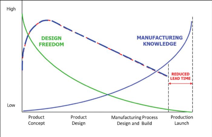

A Design for Manufacturing (DFM) workshop brings manufacturing knowledge to the product-design team early in the product concept phase when design freedom is very high and manufacturing knowledge is relatively low. Introducing manufacturing knowledge during  product concept and design has been proven to reduce tooling lead times and production costs, improve product quality, and increase production reliability (see Design for Manufacturing graph).
