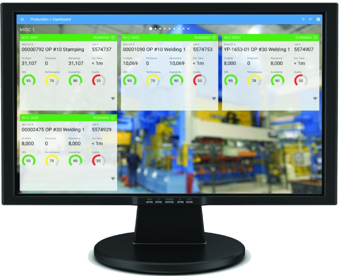

1-shop-edge-Omex-production-tracking“Only a few individuals had access to the DOS-based system, which operated more like manufacturing resource planning to oversee inventory,” recalls Justin Slawek, Omex plant manager who, in a co-op position at the time, helped deploy ShopEdge. “And, we had different software for gauge tracking, production inventory, barcode-label printing, machine maintenance and tooling. We spent time and energy trying to connect these, and the connections were a paper system. Also, we had no terminals out on the production floor. Operators had to record their downtime and the parts being produced on paper, and we had scheduling on paper.”

“When we switched to ShopEdge ERP software, we focused on ensuring that we had live data available out to the operators to simplify communication,” Slawek says. “We wanted the different facets of our organization to operate on the same system and have complete visibility off of one terminal.”

“We produce a lot of safety-critical transmission components, and our OEMs can’t produce without them,” Slawek says. “We need to deliver conforming product to our customers when they need it, and we need to be able to trace that product back. With our ERP, if a customer returns a serialized part, we can provide the day it was made; the operator who made it; the heat number, tooling condition and machine condition when we made it; and the quality checks made on the product …it’s all interconnected, and all paperless.”
