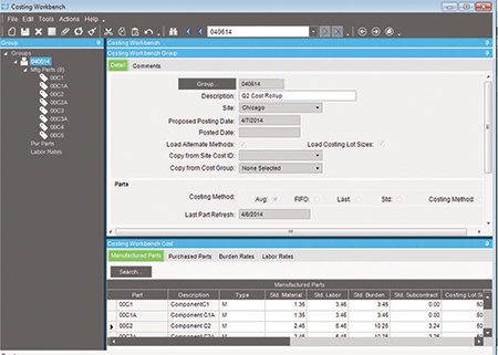

This costing workbench, one of seemingly endless tools in Dalsin Industries’ ERP system, helps the company analyze costs and cost changes for each job.

“We could not determine how well we were performing on a particular job,” Dalsin says. “We could not drill down to part-by-part, operation-by-operation information to determine what jobs were taking longer and what jobs were performing well.”

“We can follow a job through each operation, unlike before,” he says, describing how the ability to drill down into jobs provides Dalsin Industries with much more actionable information at its fingertips. “That includes the production rate attained in pieces/hr. and what was quoted. If we don’t hit the quoted numbers, we know that something is wrong. Either our projected rate is too high, or our production has a problem. We then investigate to make sure that the projected rate is correct—ensuring that an operator did not ‘wand out’ or exit the system too early in an operation or too late—and adjust accordingly. So we perform due diligence to make sure it is not simply a log-in/log-out issue. “From that point, we can assess other potential issues,” he continues. “We can work with operations managers and operators to explore setup and other processes and then make improvements.”
