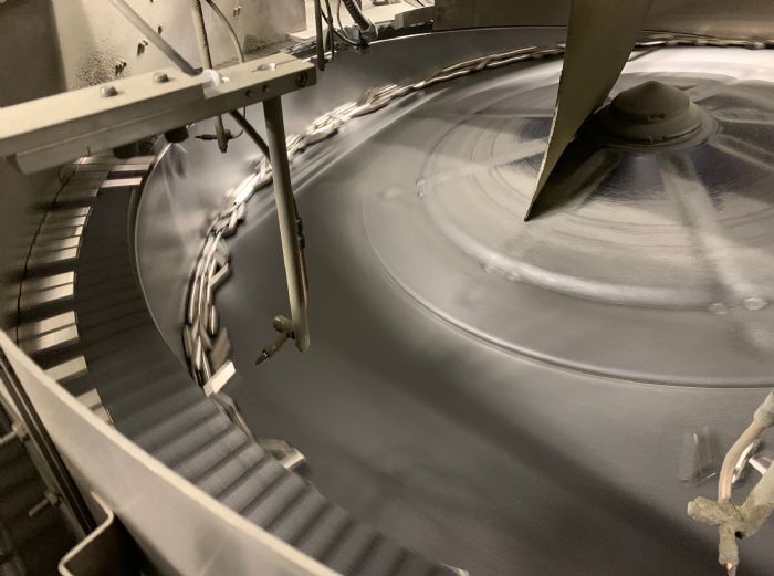

The quick feedback from the instant data reporting allowed Cushman to go to shop-floor personnel and immediately ask what was happening—why so many backward-facing cans?
“In this case, and in others, I quickly can get out to the floor and say, ‘Let’s stop the process and try to fix it,’” Cushman says, “rather than allowing them to continue to struggle. Then, when we initially conducted our troubleshooting process, data from SensrTrx immediately let us know if the fixes we were making were improving things or making them worse. Ultimately, we discovered that the culprit was the air nozzles in the bowl feeders—if we set the process to allow too many cans in the bowl at one time, the nozzles could not properly orient all of them and they’d jam. And, too few cans in the bowls would starve the coating line.”
The solution lay in fine-tuning and dialing in the line speed and controlling the number of cans in the bowl, while also dialing in the air jets so that the machine never stops. “Every stoppage is another opportunity for a can to flip around,” says Cushman. “Throughout this trial-and-error process-improvement exercise, data from SensrTrx provided the feedback we needed. And now that we have identified and fixed the problem, we can set trigger alerts should we face recurring and unacceptable stoppages, to catch and address problems immediately.”
