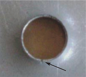

Fig. 1—A hole expansion test (HET) made with a hemispherical punch. The arrow points to the start of an edge tear that terminates further expansion. |
One important simulative test still widely used in North America is the hole-expansion test (HET). It characterizes material stretchability to help judge a stamped part’s susceptibility to edge cracking—a major concern with most parts. During shearing to create an edge on the sheetmetal, large amounts of cold work greatly reduce the material’s stretchability. This loss of stretchability can extend one-half material thickness back from the cut edge. Dull tools, improper alignment, angle of cut, clearance, mechanical properties and other process variables can further reduce the allowable stretch.
To conduct an HET, the operator punches a hole into the production material using (as closely as possible) the press conditions that match those in production. He then places the sheet on the die; draw beads lock it in place. A tapered punch (conical or hemispherical) then is driven through the hole to enlarge it until an edge crack occurs (Fig. 1).

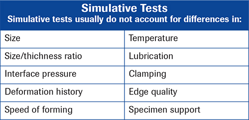

Chart listing some of the differences between small test devices and actual full-sized production stampings. |
