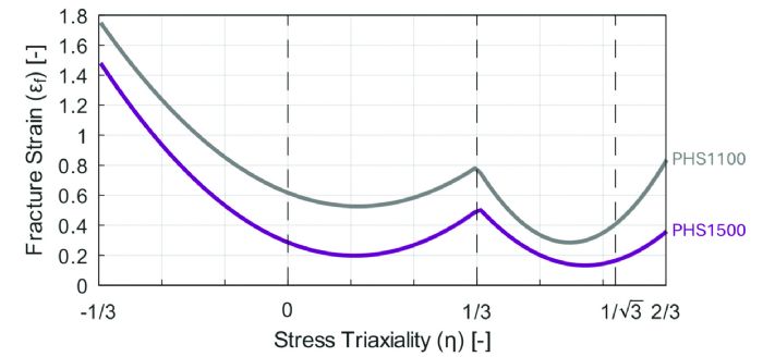

Ever wonder how manufacturers downgauge sheet metal components with higher-strength material? Consider a component originally stamped from 2-mm-thick DP590 steel—350-MPa yield, 590-MPa tensile strength. What should be the new sheet thickness if stamping the part from a martensitic steel, with 900-MPa yield and 1180-MPa tensile strength? Do we just use half of the thickness because its tensile strength is doubled? Or do we take approximately one-third, because the yield strength nearly is tripled? And, before going any further, we must first ensure that we can stamp the part from 1180-MPa martensitic steel without splits. We also must know how much energy the new design can absorb.
Believe it or not, we can answer all of these questions by consulting the local formability curves.

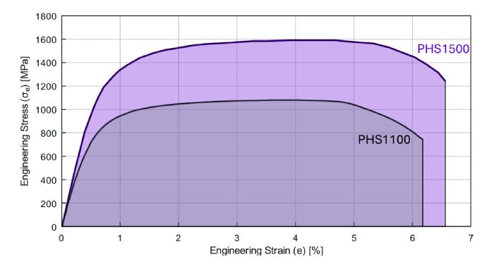

For years we assumed that a material’s energy-absorbing capacity was proportional to its area under the stress-strain curve—commonly approximated by multiplying tensile stress by total elongation. For example, PHS1500 (CR1500T-MB) steel (Fig. 1) has 1591-MPa tensile strength and 6.6% total elongation. The area under the curve (shown in lilac): 9338 MPa%. The industry approximation gives us 10,501 MPa%, a 12% overestimate. The grey curve in Fig. 1 represents PHS1100 (CR1100T-MB), a material supposedly with better energy absorption: 1188-MPa tensile strength and 6.2% total elongation, resulting in an area of 5925 MPa% and a multiplication of 7337 MPa%. In every aspect, we would expect PHS1500 to perform better than PHS1100 in energy absorption. However, drop-tower tests reveal the opposite; PHS1500 would crack earlier than PHS1100, thus absorbing less energy.
