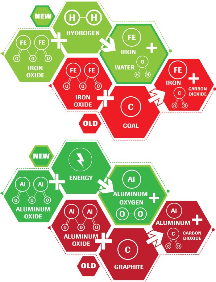

Fig 1Steel does not come out of the ground as steel; it exists as taconite, a combination of iron ore and other elements collectively described as impurities. Similarly, aluminum exists as bauxite in nature, a combination of alumina and impurities.
After removing the impurities using different but environmentally costly processes, the remaining product is iron ore or alumina. Iron ore consists of iron and oxygen, while alumina is a combination of aluminum and oxygen. The extraction of oxygen from iron oxide or aluminum oxide is a necessary precursor to producing elemental iron or aluminum.
Under many conditions, oxygen rapidly and tightly bonds with elemental iron and aluminum. Rusting occurs when iron and oxygen combine. And, the nanometer-thick aluminum-oxide layer residing on top of aluminum alloys is why we often say that aluminum doesn’t corrode. However, aluminum actually does corrode, but in a different mechanism and under different conditions.
Breaking these bonds requires energy. A blast furnace combines carbon and iron oxide, providing the conditions for oxygen to preferentially combine with carbon rather than iron. This process yields liquid iron and carbon dioxide. The electrolytic process, commonly used to produce aluminum from aluminum oxide, uses consumable carbon anodes, with the reaction producing molten aluminum and carbon dioxide.

The electrolytic process commonly used to convert alumina to aluminum requires significant electrical energy. Emissions from power production account for more than 60 percent of the total emissions from aluminum production.
Historically, the industry relied on coal-fired power plants, but newer ones use renewable energy such as that produced by hydroelectric plants. The concentration of aluminum-production facilities around Lake Ontario and nearby waterways in part relates to access to hydroelectric power.
A new type of nonconsumable inert anode nearing commercialization negates the need for carbon anodes and emits oxygen as a byproduct of the reaction rather than carbon dioxide. Use of renewable-energy sources takes on heightened importance as this approach may require greater energy input.

Until recently, DRI production used either natural gas to create the H2 and CO gases required to reduce iron ore to iron, or coking coal as the carbon source for reduction. Although energy savings result as processing occurs below the melting temperature of iron, CO2 emissions are a byproduct of this approach.
New steel-production techniques rely on hydrogen instead of carbon to reduce iron oxide to iron. Green hydrogen is the term given to hydrogen produced from renewable-energy sources such as hydropower. DRI produced from green hydrogen results in minimal emissions, becoming one of the greatest potential decarbonization approaches for the steelmaking industry. Green hydrogen is not yet commercially viable, but industry analysts project that some mills will reach commercialization in coming years. Other approaches are under investigation as well, but none appear to have near-term commercialization potential at a comparable scale.
