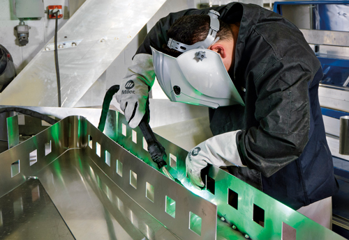

But joining aluminum sheet—for the purposes of this article, sheet measures 0.125 in. thick or less—via gas metal arc welding (GMAW) presents some challenges, as operators must take care to avoid warpage, distortion and burnthrough. The following five tips will help operators better control heat input and improve their techniques, thus optimizing results and reducing rework.

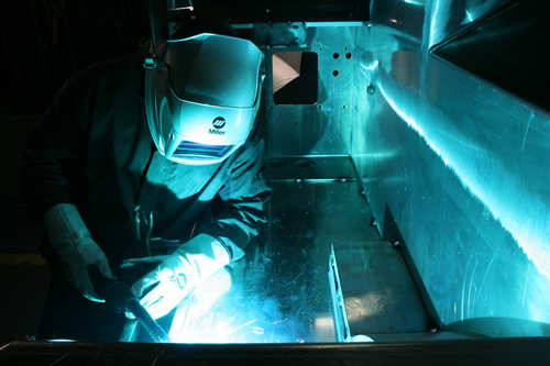

1Use pulsed GMAW welding. The right welding process helps improve results. For example, pulsed GMAW lowers the heat input and makes it easier to weld thin materials and minimize burnthrough. This welding process alternates between a high peak current and a lower background current, which lowers overall amperage. The pulse of peak current propels the molten droplet across the arc and provides the energy to produce good fusion associated with spray transfer, while the low background current allows the weld puddle to cool.
Pulsed GMAW also allows operators to run larger-diameter wire at lower currents than needed to run a non-pulsed process, such as constant-voltage (CV) GMAW. In addition, pulsed GMAW provides the ability to better control the bead profile. A wider arc cone helps tie-in both sides of a joint or an outside corner, where a narrow arc cone helps focus the arc and provides good fusion at the root of a joint. Adjusting the arc length (voltage) and wire-feed speed for optimum performance helps eliminate excess heat input, overwelding (making welds that are larger than needed or using too much filler material) and post-weld grinding.

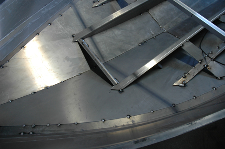

3 Take the time to ensure proper fitup. Proper, tight part fitup is essential when welding thin material such as sheet metal. Gaps between the pieces to be welded can cause warpage. Even a small gap can turn into a larger gap should a piece warp, forcing the operator to slow down to fill the larger gap, and adding unwanted heat into the weld. This can lead to bottlenecks.
In addition to ensuring no gaps in part fitup, slight overlapping of edges is recommended. A lap corner part fitup rather than an outside corner fitup offers a lesser chance of burnthrough. Another option to combat burnthrough issues: Use a copper backing bar during GMAW on sheet. This involves placing or clamping a copper bar on the back side of the welded area, which helps dissipate heat more rapidly than when relying on atmospheric cooling alone.
