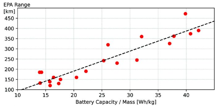

Countries outside of the United States place restrictions on gross vehicle weight (GVW). In the European Union, for example, driving an ICE vehicle with more than a 7700-lb. GVW requires possession of a commercial driver’s license. However, the limit increases to 9400 lb. if the vehicle has an alternate powertrain. These mandates bring a tradeoff between the range and the payload—especially important for last-mile-delivery commercial vans.

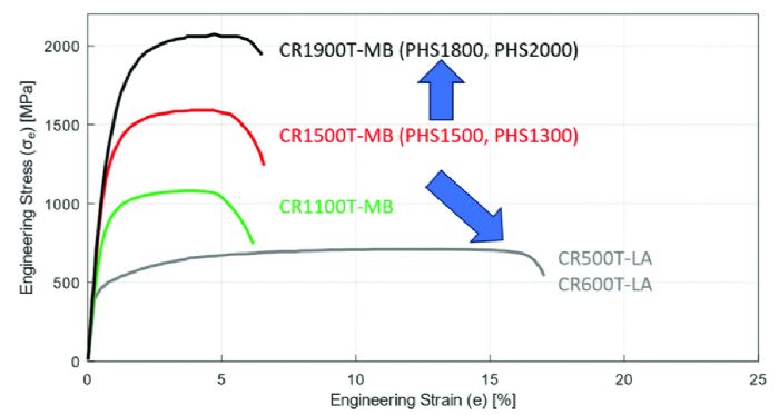

Recent years have seen the expansion of grade options with targeted properties (Fig. 2). PHS grades now can reach 2000 MPa using a different composition than CR1500T-MB, with these new grades capable of providing better resistance to passenger-compartment intrusion. Other PHS grades with tensile strength of approximately 1000 to 1200 MPa have greater ductility and allow for improved crash-energy management. Still other grades have even better ductility at a strength of 500 to 600 MPa—these are referred to as press-quenched steels (PQS) as they do not harden during the hot stamping process.

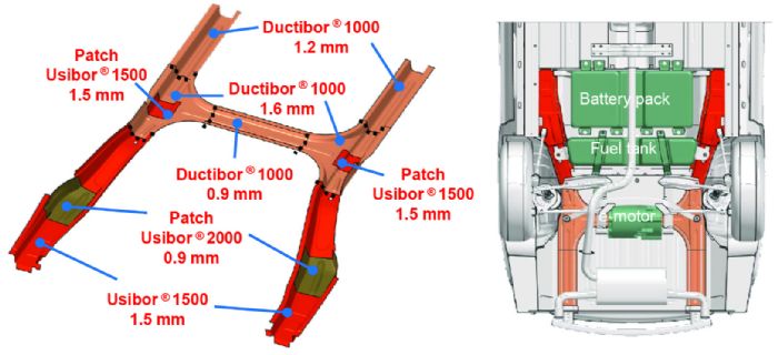

Tailoring properties in a single stamping efficiently place strength and stiffness only where needed, driving mass and cost down in other areas of the stamping. A properties-tailoring strategy in use for several decades: laser-welded blanks, comprised of sub-blanks of possibly different thicknesses, grades and coatings.
Since 2013, laser-welded or monolithic door rings have been used in several cars, trucks and minivans, typically only in front doors. Double-door ring designs now see deployment, produced as extreme-sized stampings. This approach, targeting multi-part integration (Fig. 3), results in part consolidation that changes the economics when attempting to justify its use. For example, around a battery frame, two laser-welded blanks replaced 10 individual stampings.
Part consolidation via patchwork blanks also has been commercially used for a long time. Here, a smaller blank of one set of thickness and grade is spot welded onto a master blank having different properties. Spot welding performed while the blanks lie flat proves substantially easier than attempting to spot weld a formed reinforcement onto a formed master stamping. In addition, spot welding occurs before hot stamping, so the newly formed welds go through the thermal cycle and results in a stronger welded product.
