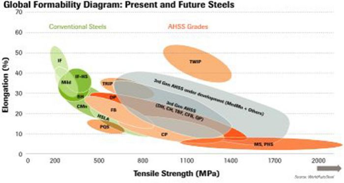

Global Formability Diagram: Present and Future SteelsThe 1980s also saw the first applications of bake-hardenable (BH) steels in Class A exposed body panels such as hoods, doors and decklids. These grades—lower strength when they arrive at the stamping plant—gain strength and dent resistance after forming and spending time in paint-curing ovens. This extra strength allows automakers to further reduce sheet thickness and reduce weight.

Global standards for 3rd Gen steels do not yet exist, with requirements contained within individual OEM standards. While approved suppliers will meet the minimum and maximum property requirements for each grade, each mill takes a different approach to meet these ranges, as the achieved properties are based on the specific equipment and capabilities at each mill. Rephrased: Approved suppliers will meet the necessary property windows but will take up a different portion of the allowed range, compared with other suppliers. Unlike mild steel and conventional high-strength steels, AHSS grades are engineered products and no longer are commodities where users can swap between suppliers with little due diligence.
In addition, we tend to describe these steels based only on their strength and elongation in a tensile test and refer to this ductility as a measure of “global formability” (see the accompanying figure). This representation fails to account for characteristics grouped under local formability, specifically enhanced bendability and enhanced cut-edge expandability. For example, it’s hard to see the benefit of CP steels solely from looking at the global formability diagram. However, these grades have a microstructural balance that gives them excellent stretch flangability (as measured in a hole-expansion test).
Similarly, other grades offer exceptional bendability without cracking, making them good candidates for crush members in crash-energy-management applications. After compiling more data on bendability and hole expansion of different grades, readers can look for a local formability diagram. MF
