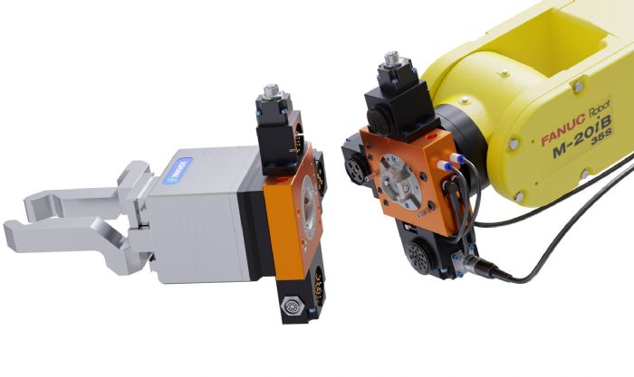

ATI Industrial Automation, Apex, NC, has introduced a new standard tool-changing option for smaller robots. The QC-29 robotic tool changer brings the powerful and rugged technology of ATI’s heavy-duty tool changers to robots in the 25- to 35-kg payload class. The QC-29 is the first standard ATI tool changer designed with a rectangular body that mounts directly to 40- and 50-mm robot wrists.
The QC-29 also includes in-body lock/unlock sensing and a new locking mechanism. Built-in air ports and three module mounting flats simplify connecting utilities. And the zero-freeplay design ensures maximum repeatability for high-efficiency tool changing.
The QC-29 is compatible with ATI’s large selection of standard utility modules and tool stands, enabling a vast array of unique configurations ranging from ultrasonic welding to servo-motor support and more.
