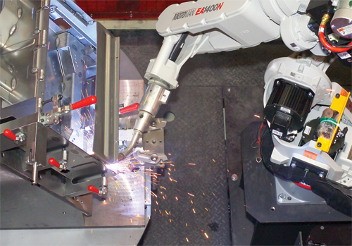

With fixed automation, a welding torch rotates around a fixed assembly, or vice-versa—the assembly rotates around a fixed torch. For example, some fabricators employ a lathe-type automated-welding setup where the fixtured assembly is spun, welded and ejected from the process. Or, the torch advances in a straight line to make, say, a 6-in. weld and then retracts to a neutral position in preparation for the next weld. Fixed automation proves extremely efficient and cost-effective.
Robotic-welding cells execute complex programmed motions in space to perform welds. Welding guns mounted on robotic arms with articulated joints can reach, rotate and pivot to gain access to the assembly. Metalformers select robotic automation when they anticipate frequent job changes or the production of particularly complex assemblies. Robots offer the flexibility to be reprogrammed and retasked as the company’s needs dictate, making them the preferred automation choice for many manufacturers.
To justify an automation investment, companies need to ensure that their part volumes are high enough, as a robot’s key benefit is the ability to produce high volumes of quality welds. Realistically, however, even though many small fabricators may lack such high volumes for any one assembly, these facilities may be able to automate two or three smaller-volume applications and program a robot to weld those different parts instead.
Part volume is a critical factor in estimating return on investment—labor comprises as much as 75 percent of the cost of a semiautomatically welded component. Accordingly, even if a metalformer plans to produce the same number of parts, it may be able to justify the investment due to the amount of labor that an automated welding process can eliminate.
