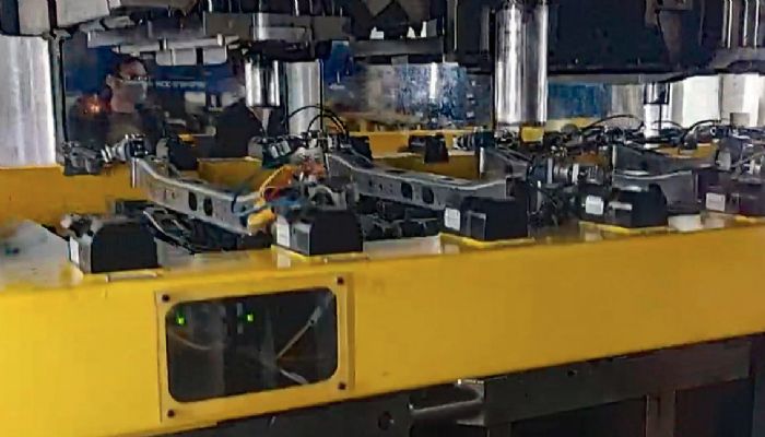

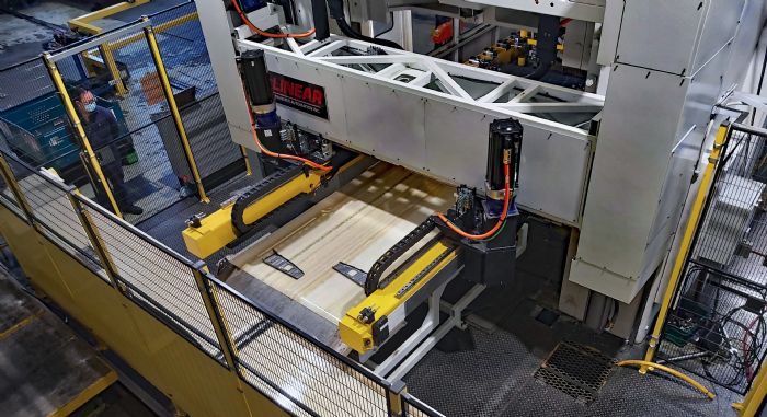

That said, the press itself remained a solid and reliable piece of equipment, and early in 2018 company management went to work in search of an upgrade solution, to breathe new life into the press. The project came to fruition in May 2020. That spring, the press was rejuvenated when Linear Transfer Automation retrofitted it with a new three-axis servo-transfer system; a high-speed pick-and-place blank feeder with two stack carts and 40-kg max payload (tooling plus blank); complete press-line entry- and exit-side guarding; and a new end-of-line 6000-mm-long conveyor, all managed by a single Allen-Bradley control platform.
