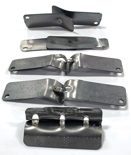

An additional challenge metal formers face when performing RW: Visual inspection of welds cannot typically ensure the required weld strength. Therefore, destructive testing often is required, unless shops opt to employ newer, state-of-the-art RW machine controls that include feedback circuits allowing the machine to compensate on the fly.
