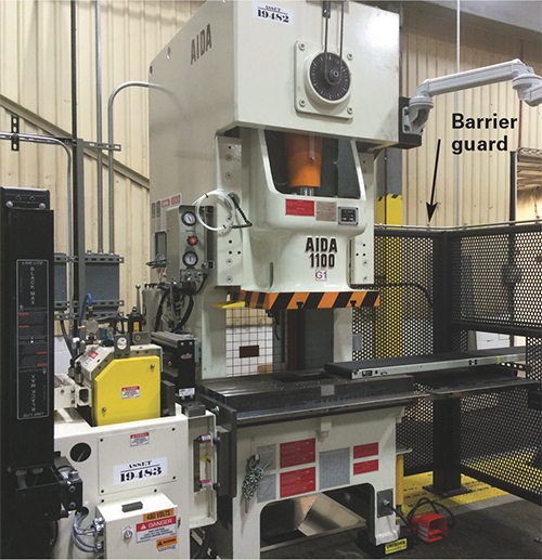

F—Vertical light curtains with horizontal remote segments protect the front of the hazard. These photos were taken during installation; not shown is additional guarding added later to prevent reach from the feed side. An L-shaped barrier extends from the right side so that the part-escapement hole allows tall parts to escape while still being far enough from the line of hazard to protect the operator. This requires the use of a conveyor to bring the parts from the tool out through the guard.
Note: All barriers mount on heavy wall 8-in.-square posts anchored to the concrete. Mesh barriers comprise ¼-in.-thick perforated-steel panels.

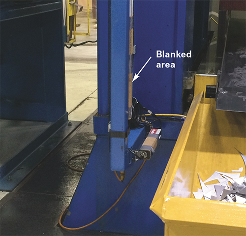

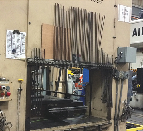

The biggest mistake we see stampers make when it comes to compromising guarding is failing to factor in the need to allow scrap to escape the die area. For most presses, scrap exits the rear of the press. For example, without giving careful thought to scrap egress, a stamper might have to raise the light curtain (photo A) to allow the scrap to exit, compromising the guarding. Photo B illustrates a similar scenario, where the stamper installed the light curtain without considering scrap egress and has blocked a very large section of the curtain to allow room for the scrap bin and for the scrap to exit, compromising the guarding. Photo C shows a similar arrangement.
An excellent option that allows proper scrap egress while continuing to protect operators is the use of a guarding zone (photos D-E). Here, physical barriers prevent access to the hazard except through the opening between them, and light curtains scan across the opening to prevent human entry without blocking the lights. The lights are set up with manual-reset fault logic. Once interrupted, even for a moment, the lights remain in fault condition even when unblocked; an operator must use a key to reset the lights and allow the machine to run.
The next biggest offender we see in the field: improper guarding of the press where the parts exit. The opening through the guarding—whether a light curtain or physical barrier—must be large enough to allow the parts to escape. Referring again to Photo B, the stamper has adjusted the opening at the exit end of the straightside press to allow for part egress, which, unfortunately also allows an easy reach into the hazard through the window. Similarly, on gap presses, the part often exits on the side opposite the feed, which creates a similar hazard.
