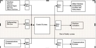

The B11.20 subcommittee recommends that users evaluate whether existing IMSs have acceptable risk using generally recognized risk-assessment methods. A risk-assessment document outlines the steps needed to bring a piece of equipment into compliance, per the appropriate ANSI and OSHA codes.  The assessment considers all aspects of the safety system, as depicted in the accompanying diagram.
ansi-b11-20-applications-white-horseRecognize that zero risk does not exist and cannot be obtained.  However, a good-faith approach to risk assessment and risk reduction should achieve an acceptable risk level.
The risk assessment is a three-phase process, the first phase being the creation of the risk-adjustment (RA) document. The second phase is verification—review of the safety design’s ability to meet the intent of the RA. The third phase is actual validation testing of the final safety-control system (SCS) to ensure that it correctly performs the required safety functions as called out as risk-reduction measures in the RA document.
