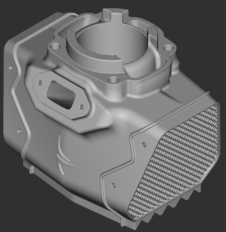

Test results on one of the team’s collaborations, Cobra Aero’s A33N drone engine, demonstrate the effectiveness of the collaboration and the technologies it offers (Fig. 1). A 3D-printed air-cooled engine cylinder—with a novel interior lattice structure designed using nTopology software and manufactured on a four-laser Renishaw RenAM 500Q machine —significantly outperformed Cobra Aero’s current workhorse cooling-fin design.
Cobra Aero carried out the evaluation in its small-engine development test cell, equipped with a full AC dyno (with motoring capability) housed in an environmental chamber that can evaluate performance in temperatures from -40 to +150 F. The test team mounted the engine on a propeller stand, with the propeller spun in various rpm ranges and operating temperature controlled by air blown through the cylinder ducts. The team continuously monitored the cylinder-head temperature.
“Testing showed that the new AM lattice structure was more efficient at cooling than our previous fin design,” Hilbert reports (Fig. 2). “In every case, at every different rpm, less cooling air was required to maintain proper engine temperature. Going forward, we can make a smaller inlet to the cooling duct, resulting in a smaller frontal area on the aircraft. This means less drag on the aircraft for the same amount of cooling—exactly what we were hoping for.”

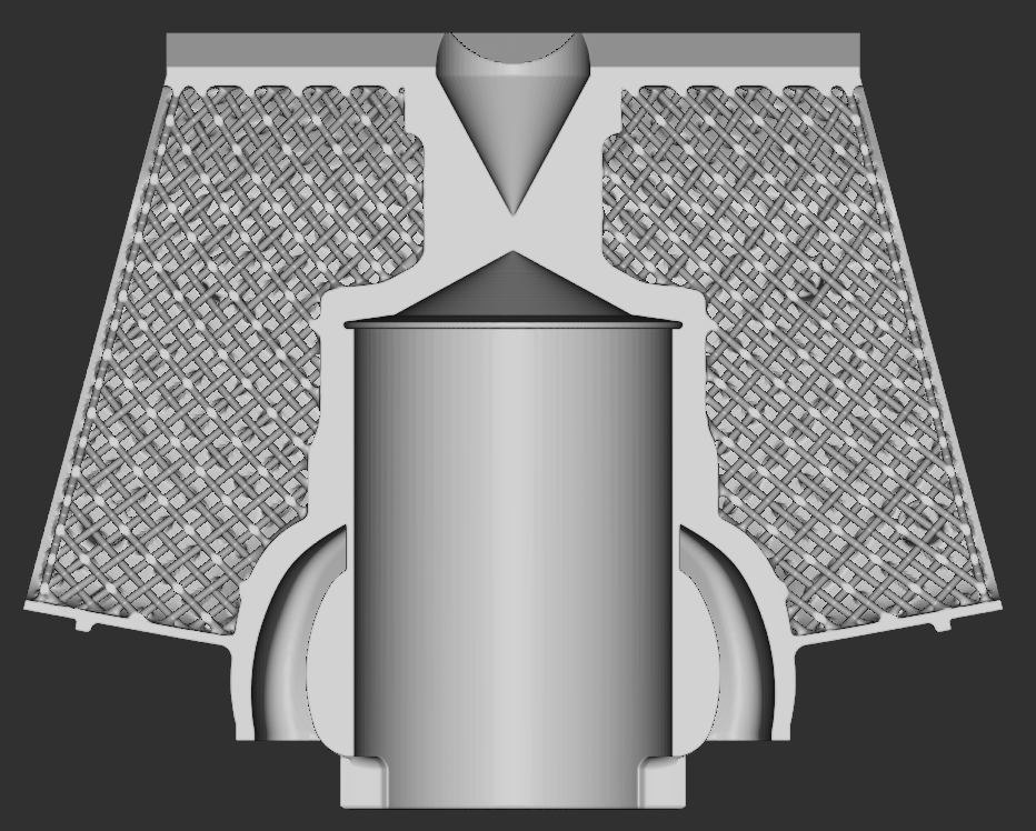

When first looking for design alternatives to fins, Hilbert’s team became intrigued by the internal lattice structures employed in products across a variety of industries, from aerospace to medical devices. By hollowing out a solid aircraft bracket or a human joint implant, and filling the space with a lattice, honeycomb or gyroid structure, weight can be decreased and strength improved. The bonus: Self-supporting lattices do not require support structures during the AM build.
“It looked like an interesting technology to use on our engine cylinders for a couple of reasons,’” recalls Hilbert. “One, a lattice structure would be very print-friendly and two, it might allow us to tailor-fit heat transfer in a better way.”

Using nTop Platform’s automated capabilities, Cobra Aero quickly filled in the lattice inside of the cylinder geometry and terminated it on a highly undulating surface. The team considered a variety of configurations, with the software readily handling all of the generated data.
“AM offers so much design freedom, but realizing that potential comes down to properly representing and designing geometry, which is what our software does,” says Jonathan Harris, lead application engineer for nTopology. “Our implicit algorithms and field-driven design capabilities give designers the ability to synthesize all different sources of engineering data on a single platform, choose how each influences their design, and easily and automatically change and rebuild to fit desired parameters.”
The software allows rapid consideration of different lattice structures, automatically filling in fillets (see Software Automation Simplifies Complex Modeling sidebar) to broaden and smooth strut intersections and connections to the part skin (Fig. 3). This distributes stress uniformly, according to nTopology officials, reducing concentrations that can lead to delamination, and promoting manufacturability and durability.
“By the time we were done, our models had evolved to the point where they were simply beautiful,” says Hilbert. “Apart from the lattice, we soon realized many other advantages to using the software. We were able to integrate the cooling duct with the cylinder itself, consolidating parts into a single piece. Overall, the design is clean and simple―a tighter package that prints perfectly and presents itself very nicely on the engine.”
Working together, the team arrived at a trio of cylinder designs ready for 3D printing and real-world testing. nTop Platform then produced the engine cylinder part-geometry data in the sliced format required to drive the path of the laser in the layer-by-layer AM process. Renishaw printed the lattice iterations―(33.5-hr. build time) ―at its West Dundee, IL facility, as Cobra Aero’s own Renishaw machine was fully booked with customer projects at the time. Testing revealed the best cooling results from a middle-lattice configuration.
