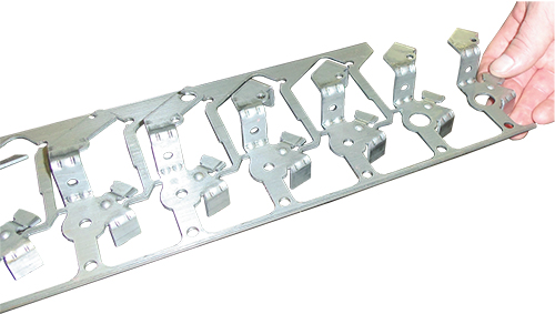

With the data imported, he determines where the entry point will be made on the die. “Once I get all of the stations unfolded,” he explains, “I can bring it into the software’s strip study and build the components around the strip.”
VISI enables Bobby to easily generate 3D strip layouts, on which he can use the software’s automatic blank alignment, rotation and optimization functions to create the most efficient strip possible. The software also includes an automatic 2D-strip-plan option, which assists in punch design and includes fold lines.
VISI then formulates the part-unfolding process, allowing Bobby to plan each forming stage, by dynamically adjusting bend angles. The solution also allows him to incorporate parametric features—ribs and bosses for example—that can be used or deactivated throughout the forming process. With flexible editing, stations can easily be added or removed.
“I start with the last station and work backward, deconstructing the part and breaking it down,” Bobby says. “The strip basically is the plan of how we’re going to make the tool from a block of steel.”

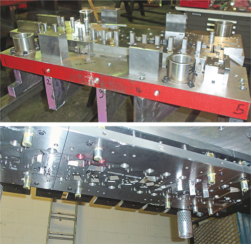

He also credits the collision-detection capabilities of the software for helping him create error-free press-ready designs. While DeCore tests its dies inhouse, all production of final parts takes place after the finished product has been delivered to the customer.
“Being able to see the 3D model and check interferences helps save time in the press,” Bobby says.
