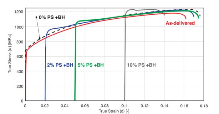

In 2017, I, along with a group of researchers, completed a study similar to Volvo’s with a 3rd Generation TBF (TRIP-aided bainitic ferrite). Since the material had nearly twice the elongation of DP980, we strained it to 10 percent and bake-hardened it. With 2 percent or more pre-strain (Fig. 2), the material could easily have a yield strength of 1000 MPa after paint baking, almost on par with PHS 1500.

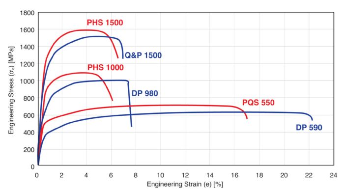

Cuting Edge Fig. 3In 2013, Nissan became the first automaker to use 3rd Generation AHSS in its body-in-whites, including use of TBF1180 in several components of the Infiniti Q50. In 2019 Mazda used 1310-MPa cold-stamped steel, surpassed by Nissan in 2021 when it used 1500-MPa cold-stamped quenching-and-partitioning steel (Fig. 3). (Controlling springback with these high-strength cold-formed grades required significant investment.)

In 2014, Mercedes rolled out its 4th generation C-Class vehicle, with several components made of PHS 1500 and laser-welded blanks of PHS 1500 and PQS550. Until this time, many OEMs and Tier suppliers seemingly used PHS for strength and PQS for energy absorption. Mercedes used PQS to ensure precise part dimensions for geometric referencing. When using DP or TRIP steels, mechanical properties of the steel would vary, affecting springback and geometry. When using PQS550, parts had very high repeatability. In addition, cold-forming DP steels reduces their residual elongation (Fig. 2). As-delivered TBF980 steel has 16-percent total elongation, while adding 5-percent pre-strain results in 12-percent residual elongation. However, a hot formed and quenched PQS has all of the elongation shown in Fig. 3 nearly everywhere in the formed part. Finally, hot forming PQS550 optimizes ductility for crash-energy absorption (Fig. 2).
