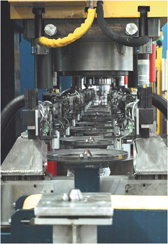

A Tennessee Steel operator prepares the four-press transfer line to stamp torque-converter supports, from 295-mm blanks of 2-mm-thick steel. The job requires seven press stations, so it runs in two setups—stations one through four run right to left, beginning with an automatic blank feeder; following a die change, the parts run in reverse through die stations five through seven, left to right.
Between stations one and two, the transfer system rotates the blanks 180 deg. and flips them over. Watch the line run, and get a look at the blank rotation-and-flip setup.

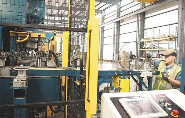

That solution came early in 2012 in the form of four 200-ton Komatsu gap-frame presses linked by a servo-transfer system, from Linear Transfer Automation, Barrie, Ontario, Canada. In fact, Linear Transfer, along with its distributor Production Resources Inc., completed the entire turnkey project for Tennessee Steel, including a blank destacker, die carts (two per press), quick-die-change apparatus (hydraulic clamps, lifters and bolster extensions), safety light curtains, magnetic conveyors, electric scrap shakers, and even a new press foundation.
A press operator visually inspects each support as it exits the line, at a production rate of 13 parts/min. When the firm replaces magnetic transfer tooling with grippers and shovel-style tools, it expects to be able to kick throughput up by at least a few parts/min.

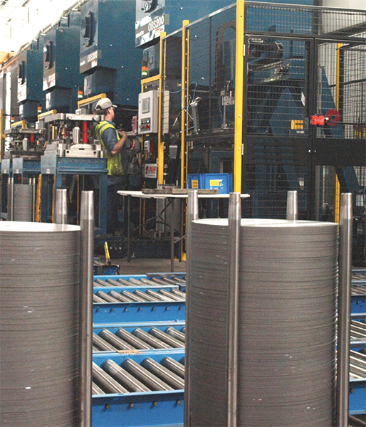

The transfer line runs two shifts/day producing three torque-converter part numbers for Exedy—turbine and impeller cores, and torque-converter supports. A fourth part number is slated to make its to the line early next year—turbine shells—which will require running the transfer line around the clock. Of the firm’s 18 employees, four are trained on the transfer line. Two work the line at a time. Blanks feeding the transfer line come from the plant’s blanking press, and account for 20 percent of that press’s output; the remainder of the blanks gets shipped up the hill to Exedy.
“The cores are the easiest to run on the line,” says Price. “They are small (183-mm-dia. blanks), from 1-mm material and are lightweight. These take only three press operations, and here’s where the custom engineering provided by Linear Transfer really helps. They engineered the line so we can place an outbound conveyor anywhere between the presses, to remove parts from the line. We have the conveyor mounted on casters so we can easily move it along the line, to any of three stations where we typically pull parts off, depending on the job.”

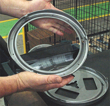

Seven press stations, over two setups, make these torque-converter support stampings. On the table sits parts as they exit stations one through four. Station one makes the hole cutouts, designed to provide just the right amount of material to allow the steel to flow properly throughout the remaining stations. Station two coins both sides of the part, and stations three and four stand up the forms. After a die change, the blanks are hand-fed back into the press line for processing at the remaining three stations.
Stamping the supports requires a more complex process involving seven press operations. Blanks—295-mm dia. and 2 mm thick, in lot sizes of around 9000—feed through all four presses in the transfer line for trimming, shaping, coining and flanging. Between presses one and two the transfer system spins the stampings 180 deg. and flips them over. Once the production run has completed, the plant executes a complete die change on the four-press line and the stampings run through three additional operations, feeding in the reverse direction along the line—left to right.
