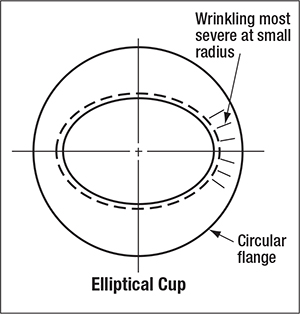

Axisymmetric cup drawing is rather straightforward and easily understood. However, not all cup drawing is symmetrical about the cup axis. Consider deep drawing elliptical shapes, for example, where the uniform compressive loads found in axisymmetric cup drawing are disrupted. This causes wrinkles to form in the flange due to unbalanced peripheral flow of material toward the punch (Fig. 3). Metalformers can reduce these compressive loads by notching the blank in the smaller radius area, provided that the notch will not affect the final product trim. Again, a programmable servo-cushion may offer a better solution, by allowing the user to selectively apply pressure at specific locations on the flange. This will suppress wrinkles without restricting material flow at other locations.
