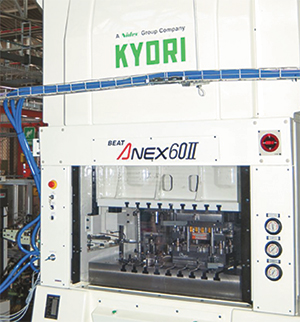

The latest such upgrade: a 600-kN Kyori ANEX 60II mechanical press outfitted with a Kyori GX gripper-feed unit—ideal for feeding parts such as narrow-pitch connectors—and two Bihler in-die welding units. Bticino employs the press line, installed in February 2013, to stamp complex connectors at 250 strokes/min. Key press specifications: 300-mm shut height and 80-mm shut-height adjustment; 1100- by 600-mm bolster area; 840- by 120-mm bed opening.
Kyori ANEX presses, sold in North and South America, as well as in Europe, by Nidec Minster Corp., Minster, OH, feature knuckle-link slide motion, cast-iron frame construction, combination air friction clutch and brake unit, continuous press lubrication and electronic stroke-position indicator.
