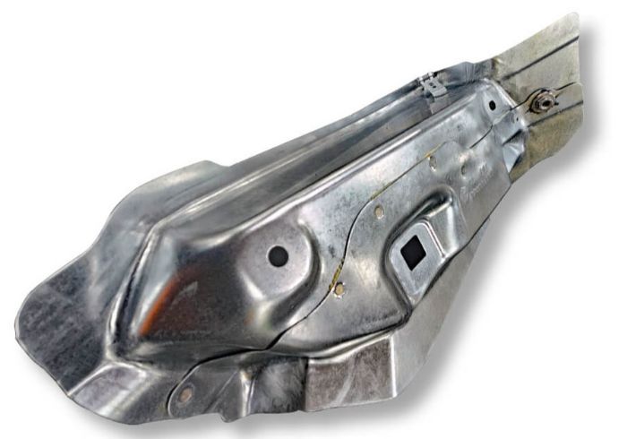

Photo B taillight stamping 2Companywide, the firm operates presses from 150 to 3000 tons, running progressive, robotic-tandem and transfer tooling. Presses to 800 tons run progressive dies; the facility’s four larger presses run larger parts via transfers as well as progressive dies..
Matcor Matsu also specializes in in-die processes—welding and clinch-nut insertion. Among the products it stamps and assembles: cross car beams, fuel-tank straps and taillight assemblies are big runners. The plant also stamps hinge brackets and motor mounts.

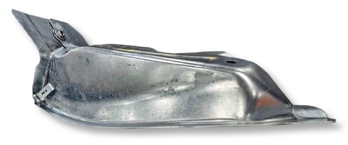

Photo A taillight stamping 1“Taillight assemblies are a big one for us,” explains engineering manager Tyson Spangler. “We produce them in three different varieties. Another big runner is wheelhouse assemblies.”

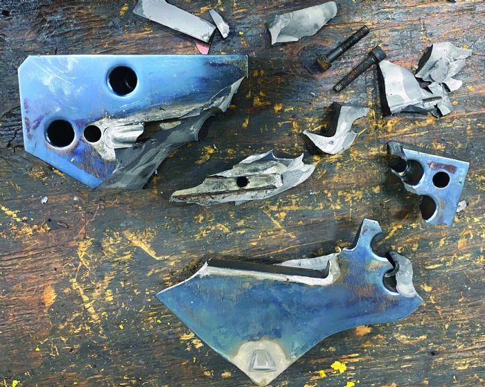

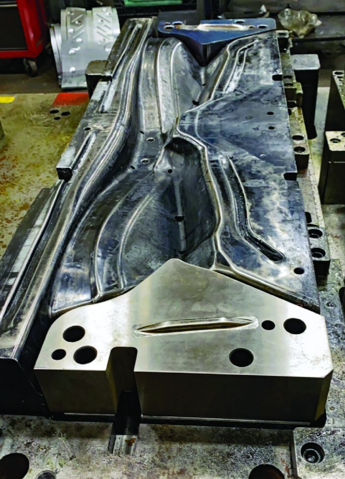

Photo C stamping die taillight assembly“A couple of years ago we brought in a new die for these parts fabricated from D2, with many of the details coated,” Spangler continues. “Running the tool in a 1300-ton mechanical press, a few of the details cracked apart after about 250,000 hits. But even before that, the details exhibited quite a bit of wear, which led to galling. We subsequently replaced the D2 details with DCMX. The improved die has been running for nearly a year, making more than 300,000 hits, with no sign of wear yet.”

Photo D exploded die detail D2“We’ve even machined draw beads from DCMX, and they run great—uncoated,” shares toolroom leader John Johnson. “The DCMX beads definitely outperform D2 draw beads. Across the board, DCMX tool details perform noticeably better. We see the same results for trim details, where we’re averaging five to six times the die life of D2 details.”
