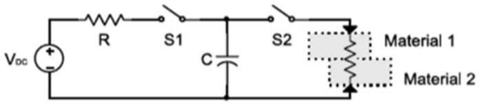

Taylor-Winfield-CD-Welding-CircuitTo better understand multiple-pulse CD welding, it’s best to start with the basics regarding all CD welders. With CD welding, a form of resistance welding, capacitors deliver weld current to the part. Capacitors are charged with large amounts of energy. Then, while isolated from the grid, the energy releases rapidly into the parts within milliseconds (Fig. 1). This leads to fast and consistent welds independent of a potentially fluctuating power supply.
Multiple-pulse CD welding functions similarly. Capacitors are charged in parallel, then discharged in isolation from the grid. However, multiple pulses introduced into the CD system increase the number of variables, causing a drastic increase in the range of potential schedules. With most single-pulse CD systems, a user can modify the charging voltage of the capacitor, which represents the only variable. With multiple-pulse CD systems, additional capacitors are introduced into the equation.

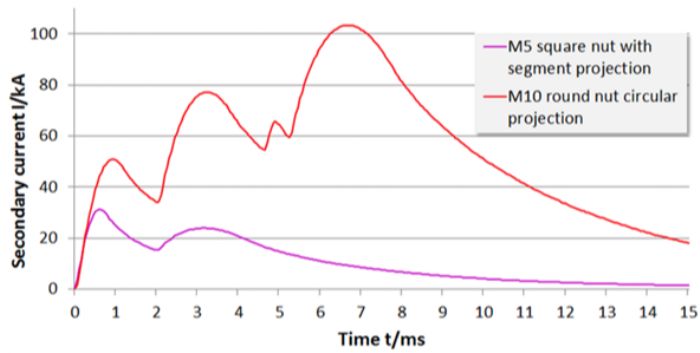

Taylor-Winfield-CD-Four-PulseThe addition of pulses produces n-1 time variables, where n represents the number of available pulses. The time variables represent the time intervals from weld initiation to the firing of each individual pulse. Fig. 2 demonstrates a four-pulse capacitor discharge-current curve and helps explain the key role that time plays when more than one pulse is introduced into the system. As time increases between the first and second pulse, the apex of the second pulse will shift to the right and decrease. The apex will decrease because the current from the first pulse has more time to dissipate into the part. Thus, the circuit will have less current available to add to the peak current of the second pulse. The opposite occurs as the time interval decreases. As the number of pulses increase, the compounding effect becomes increasingly noticeable, as indicated by the peak of the fourth pulse.

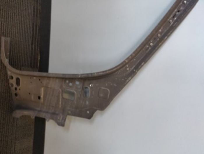

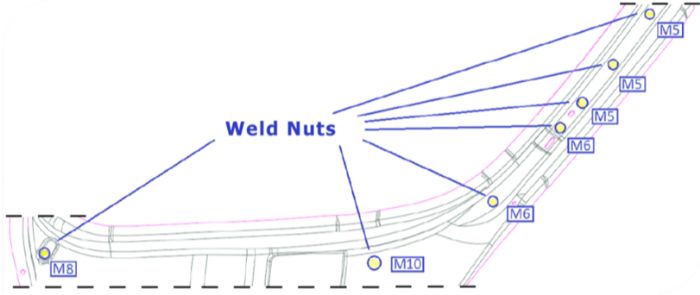

Taylor-Winfield-SUV-side-memberTaylor-Winfield-weld-nutsThe versatility of multiple-pulse CD systems is demonstrated on the side member of a SUV as shown in Fig. 3. Due to the wide range of possible schedules, all four sizes of weld nuts were able to be welded to coated AHSS with the same CD welding machine. This was achieved by strategically coupling the four available pulses. The capacitor with the smallest capacitance was used first to provide a low-energy pulse for removal of the coating and any surface impurities without achieving any bonding. Then, the second, third and fourth pulses provided the energy necessary to achieve the solid-state bond. Utilizing the first pulse only to remove undesirable surface conditions and initiate heat generation without creating a bond has proven to be advantageous when welding AHSS.

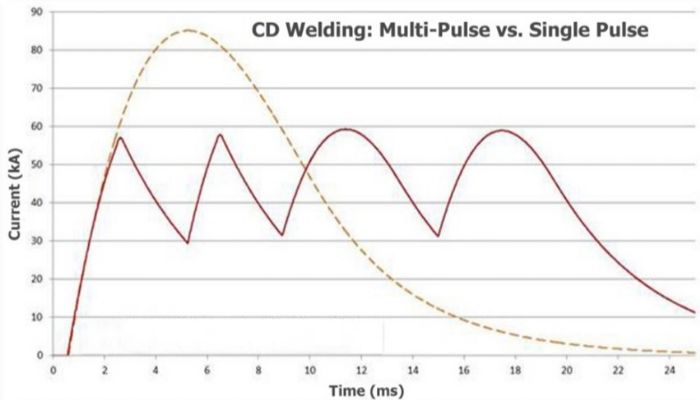

Taylor-Winfield-single-pulse-versus-multiple-pulseApplying excessive peak likely will form macro-spatters in addition to micro-spatters. Macro-spatters disrupt the integrity of the weld nut threads and weaken the resulting joint. In conventional single-pulse CD welding, more common is the need for excessive peak current to ensure enough overall energy to complete the weld. When incorporating multiple pulses, total energy input (the area under the current curve) can be increased without the need for excessive peak current. Fig. 4 demonstrates how multiple-pulse systems enable an operator to increase the total energy input without extending beyond the necessary peak current to produce a quality bond.
