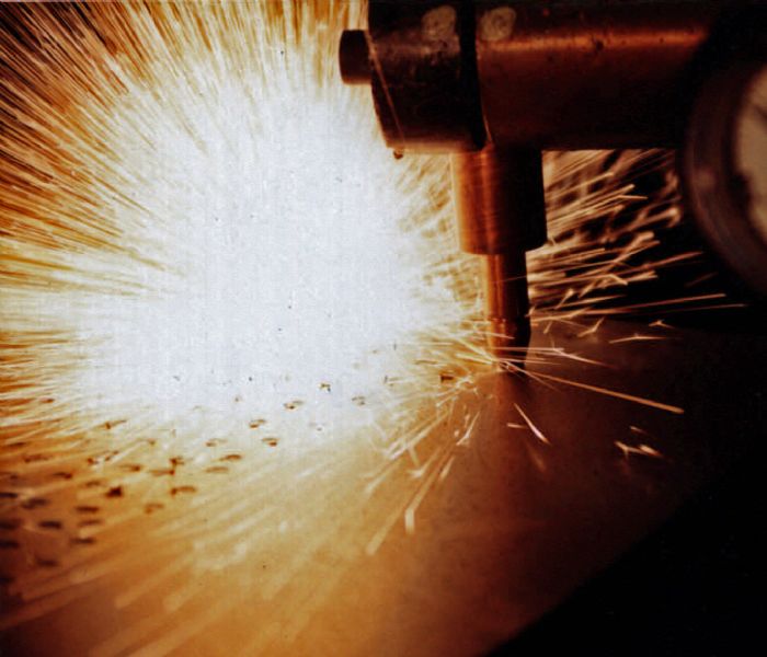

To reduce the potential for expulsion, use a proper welding schedule developed specifically for the type of workpiece material. This starts by setting a squeeze time long enough to allow the electrodes to touch and rise to full force before welding current starts to flow. Some RW controls employ a differential pressure transducer system to automatically ensure full force is reached before the start of weld heat.
Next, selection of the proper electrode force, which creates a mechanical barrier around the molten metal to keep the material within the nugget area and eliminate expulsion. It also reduces the electrical resistance between the electrode face where it contacts the outer sheet, reducing surface heating under the electrode and preventing it from reaching the molten state. This results in a visually clean, smooth area for each weld spot.
FIg. 2 anti-tiedown initiation resistance weldingHowever, use of excessive weld force reduces the amount of heat created in the nugget zone and compromises weld strength or, in extreme cases, eliminates fusion. The “RWMA Resistance Welding Manual Edition 4” (available at rwma.org) includes a collection of welding schedules for most metal alloys to provide high-strength welds while eliminating expulsion.
Another cause of expulsion: placing a spot weld too close to the edge of a part. Here, even use of proper electrode force will not prevent molten metal from flying out of the workpiece edge. The RWMA handbook recommends minimum edge distances to minimize expulsion. However, where part design forces a weld location too close to an edge, metal formers can employ a pulsed-current welding schedule to minimize expulsion while maintaining weld strength. For most alloys, divide the weld time recommended in the RWMA handbook by 3 (round up), and install three pulses of this time with two cycles of cool time between pulses. This will minimize expulsion and form a nugget with acceptable penetration. (For an extensive article on electrode force and expulsion, visit www.unitrol-electronics.com. Click on Support, Improving Resistance Welding, and The Effect of Tip Force on Weld Quality and Electrode Life.)

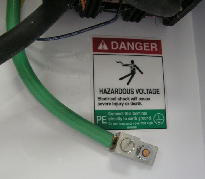

Electrical Shock
By design, an RW machine uses low voltage at the electrodes to produce an intrinsically safe process. However, an incorrectly grounded machine can pose potentially serious shock danger to the operator. Here, a potentially fatal shock can occur if the primary winding of the welding transformer shorts to the transformer secondary winding, or if a line-voltage connection in the transformer housing comes loose and shorts to the machine body.
With a properly grounded machine, the line voltage will find a good path to ground and clear the control’s circuit breaker, line fuses or main power circuit breaker. Proper grounding depends on the quality of the incoming ground wire to the machine. Do not ground an RW machine using the conduit or BX cable. The separate ground wire should enter the welding-control enclosure and connect to a properly bonded ground stud. The wire, sized large enough to handle at least 50 percent of the current capacity of the incoming main power, should connect on one end to earth ground (Fig. 4).

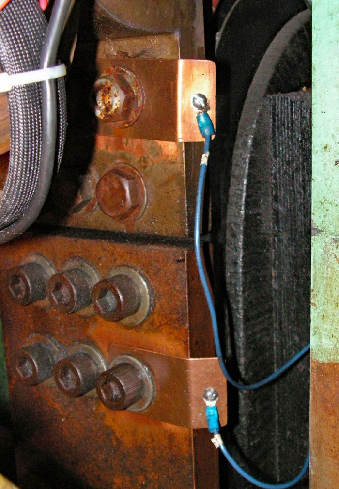

OSHA standard 1910.255(b) (9) reads: “Where technically practical, the secondary of all welding transformers used in multispot, projection and seam welding machines shall be grounded. This may be done by permanently grounding one side of the welding secondary current circuit. Where not technically practical, a center tapped grounding reactor connected across the secondary (is acceptable).”
Floor- or bench-mounted press and rocker-arm RW machines typically are manufactured with the stationary arm bolted to the transformer secondary pad and connected to the machine frame. Grounding the machine frame completes the path from welder secondary to ground; the movable machine arm is not grounded.
Machines that use a permanently mounted transformer connected to a portable welding gun by a long kickless cable require a ground strap to connect either side of the transformer secondary to the transformer frame. With the transformer frame properly connected to a ground wire, the path from the portable welding gun to ground is fully established.

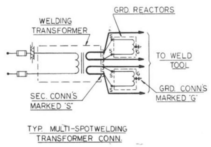

Multiple Transformers
RW machines that employ multiple transformers on the same structure require special grounding (Fig. 5). Connecting one side of the machine’s secondary on multiple transformers to the common ground causes ground paths to run through the workpiece and fixture. These ground paths easily can weld or tack the parts to the fixture. In addition, electrical paths may run back through the workpiece to other grounded electrodes, causing arcing throughout. For this type of application, metal formers should install a grounding reactor on the transformer secondary in place of a hard-wire ground.
These devices contain an internal coil connected across each weld-transformer secondary with a third wire from the center tap on the coil connected to ground. The coil has high impedance when voltage applied across it is less than 24 V. However, should the transformer secondary become connected to line voltage, due to a transformer internal short, the coil saturates and becomes a very-low-impedance device. This drains the line voltage through the ground wire, producing excessively high current that should trip the control’s circuit breaker or blow the fuses. If the transformer has two secondary circuits, be sure to install one grounding reactor on each circuit.
Finally, with permanently mounted transguns, complete the ground path by connecting either side of the machine transformer secondary to the transformer frame. When using multiple transguns in a system, or where arcing to the fixture may occur, employ a grounding reactor for each welding transformer secondary in place of a hard-wire ground connection. MF
