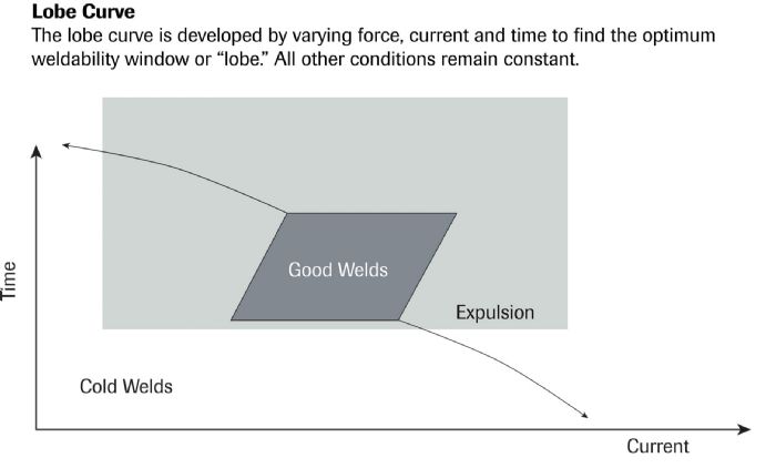

Modern RW controls provide accurate timing measured in cycles or milliseconds. However, we often see confusion regarding the meaning of the sequential timing functions called squeeze, weld, hold and off.
The unfortunately named control setting called “squeeze time” has nothing to do with regulating the weld force applied. Instead, think of squeeze time as electrode-travel time. When properly set, squeeze time allows the welding electrode to contact the part and achieve the desired force prior to initiation of the welding current.
Insufficient squeeze time results in the RW control firing the welding machine’s transformer before the application of full weld force, which causes expulsion and weak welds.
As previously noted, set weld time as short as possible. Subsequently, hold time—in sequence immediately after weld time—allows the weld to cool for a short period with the weld force still applied. Then, off time only is used if the welding machine is set to automatically repeat, similar to a sewing machine.

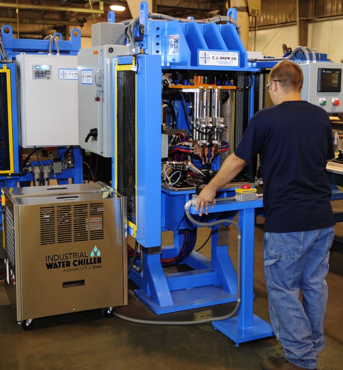

Cooling Water
As most RW machines are water-cooled, do not overlook water flow rate and temperature as key process variables. RW machines are thirsty and adequate water flow typically is more important than water temperature. For example, a high flow rate of 80-deg. water will prove more effective than 45-deg. water at a low flow rate.
As the cost of using city water to cool an RW machine can be high and the incoming temperature often too cold, the simplest solution is to employ a closed-loop recirculating system. Beware: Some of these systems operate better than others. And, as with all things related to RW machines, consistency holds the key to success.
Common machine water-cooling gotchas:
- Cooling towers are not ideal for suppling RW machines, because changing ambient-air temperatures cause inconsistent cooling-water temperature.
- We also do not recommend the small radiator-type recirculators commonly used with arc-welding machines, due to low flow rates and changing temperatures.
- Plant-wide water systems often provide inconsistent flow rates due to varying head pressure.
- When water systems use black-iron plumbing instead of PVC, rust will eventually clog the welding machine’s small-diameter internal water-cooling lines.
- City and well water contain minerals that will clog water-cooling circuits over time.
- The best choice: a properly sized self-contained water recirculator/ chiller. However, with these be sure to set the chiller’s water temperature above the prevailing dew point or condensation will form. This can cause the welding machine’s transformer or weld control to become saturated and eventually short out.
