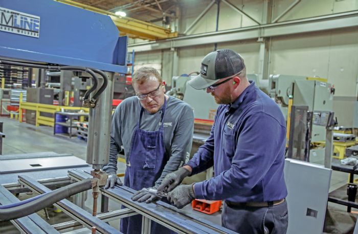

Knapheide employs some 900 people on the shop floor, 70 percent of who perform welding operations across three shifts using inverter-based gas-metal-arc-welding (GMAW) power sources, stationary RW machines and six hand-held RW guns.
The company established an internal welding program in 2001 to train employees on the science of welding, so they could better understand problems and how to solve them. As senior personnel continue to retire, the original 24-hr. training program has expanded to two full weeks of training. Given today’s hiring challenges, training becomes more essential and is in fact mandatory for all potential operators, regardless of extent of welding experience. Prospects are hired for their promising work ethic and team-oriented attitude, but they usually need to learn RW mechanical skills and related technology.
“About 30 percent of our training is classroom-driven, with the balance hands-on,” says Murry. “At the end of the training program, the student-employees develop and build actual products off of the assembly line with no pressure to meet specific productivity goals. That way, when they get to the shop floor we know they have the required skillset. We supply everything trainees needs except for their steel-toed boots.”
Meeting the Need
After implementing a successful GMAW training program, Murry earned responsibility for RW training, which had been managed by the manufacturing department. After spending considerable time exploring available training curricula, Murry realized that nothing met Knapheide’s needs. He jumped at an invitation to participate in the development of the AWS CRWT training, attending AWS committee meetings and providing 13 company employees to take a beta test exam.
“We wanted training that would help us develop our inhouse training program, as well as training for our welding team so that they could train our operators,” says Murry. “In addition, we wanted to learn how to troubleshoot equipment, write our own weld schedules and understand such things as the differences between welding stainless steel and galvanized steel. After our team completed the CRWT seminar in August 2021, I can confirm that the course did an outstanding job of covering all of the information that we need to succeed.”

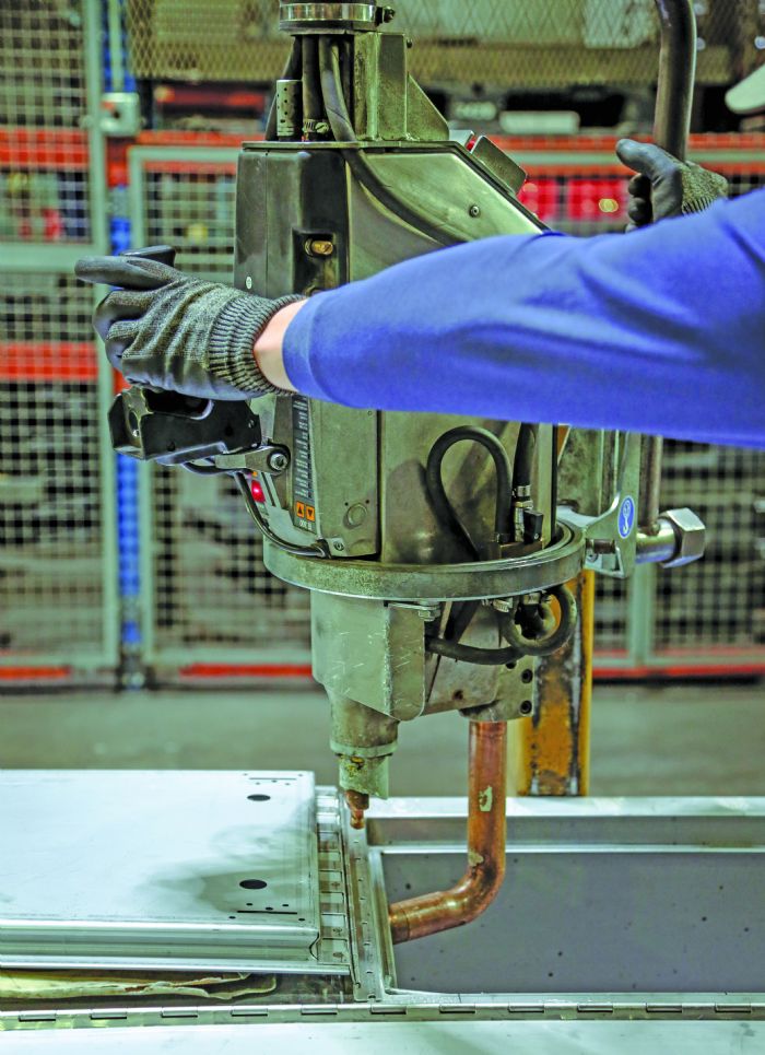

As an example, one product manufactured on the plant floor requires spot welding a backplate to a stake. For years, the company fought expulsion—the forceful ejection of molten metal, which reduces weld strength and even can create a through-hole. During training, the welding team learned how creating weld schedules with more slope (ramping up weld energy over time from the beginning of the weld) can affect the results.
“Adding slope made the sheet metal more malleable, which closed the gap between the backplate and the stake before applying full welding power,” says Murry. “We understood part of the problem, but didn’t have a full enough understanding to fix it. Now we do, and we have since largely eliminated expulsion.”
For his part, Sparrow says that during the seminar training he learned a lot about electrodes and the effects of changing electrode shanks and caps.
“The face diameter of the electrode cap can dictate where the majority of the resistance occurs within the parts,” he says. “We learned how to control the level of reinforcement by using smaller or larger caps, which has made us more successful.”
In another instance, a machine had been set up to run a particular product but experienced problems after switching to a different product and associated weld schedule.
“After hours of failure, we finally started to think outside of the box,” says Sparrow. “We recalled the lesson about spot-weld cap profiles, so we changed caps to a different style. Now we’re able to use the same electrode combination for every product the machine runs and create uniform welds.”
