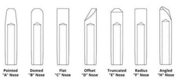

Domed electrodes find a lot of use in the automotive industry, because they can help solve alignment issues and are easily dressed in an automated process. Flat-faced tips find use for applications requiring a good “show surface,” although weld heat must be concentrated from the opposite side of the weldment with a pointed or domed-tip electrode. When making show-surface spot welds, think of the electrode’s weld face as a printing press, because each weld will leave a “picture” of the tip end.
Welding aluminum? Electrodes with a slightly radiused weld face find use here. And, according to Bill Brafford, who retired after a long career with RW electrode manufacturers CMW and Tuffaloy, “when welding galvanized material, use tips with a truncated nose, because the unavoidable expulsion will not form a ‘dam’ around the weld face.”

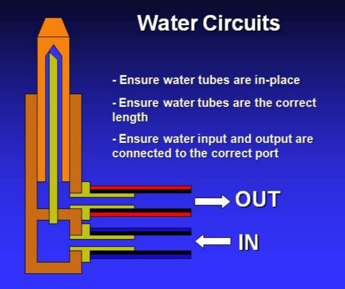

by Roger Hirsch, president of Unitrol Electronics, Northbrook, IL, a manufacturer of RW controls and recirculating water chillers. I recently received a call from the welding engineer at a Tier Two manufacturer, explaining that she had been experiencing poor electrode life from the firm’s 35 RW machines. With this many machines, replacing the copper electrodes proved quite costly, but not as costly as the lost production time required to replace the electrodes. In a 2-yr. study, the company found that it had to replace its RW electrodes 30-percent more frequently during the summer months compared to winter months. Since production load did not vary by season, I surmised that the temperature of the water being used to cool the electrodes was the culprit. Further investigation revealed that the temperature in the water tower supplying the RW machines was 15 to 20 deg. higher during the summer than the winter. The solution: Eliminate the water tower and install a refrigerated-water system in the plant’s welding department. And, as an aside, this setup also eliminated water contamination from the water tower, which periodically clogged the cooling tubes inside of the electrode holders. After installing the refrigerated-water system, electrode life improved by 25 percent when compared to the best electrode life recorded during the coldest winter months, and did not change by season. |
Proper water cooling is critical to long electrode life and most tips come with drilled internal water passages. Copper, brass and plastic tubes with one end cut on a 45-deg. angle will help force cooling water inside of the electrode, as close as possible to where heat is generated during the weld (Fig. 3).
Unfortunately, operators oftentimes will not understand the importance of water tubes, and will lose them or throw them away—a costly mistake. In addition, pay attention to the temperature of the cooling water supplied to the electrodes, to prolong life (see the accompanying sidebar).

Finally, while some applications will require the use of double-bend offset tips, to access difficult-to-reach weld locations on narrow flanges, for example, shops should avoid offsets where possible. Offsets will tend to deform due to low physical strength and poor water cooling—particularly when using expensive offset tips made from copper castings.
In place of offset tips, try using a standard, straight tip, with an offset nose mounted in an offset electrode holder. Consult available tip catalogs for illustrations of various electrode and holder combinations that will provide the required reach into challenging weld locations. MF
