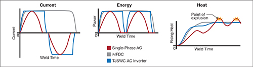

This comparison of the different methods of controlling and regulating the energy shows how the more advanced methods, MFDC and TJSWC AC inverter, deliver more efficient energy by reducing the off time between welding pulses.

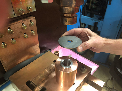

Shown here, an example of typical part geometry and tooling for a part being welded using capacitor-discharge welding. Notice the ring projection.

The waveform shows how two of the more efficient forms of energy delivery, medium-frequency DC and the AC inverter, compare with the conventional single-phase AC process.
