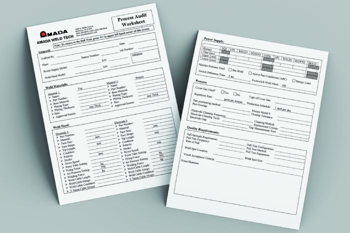

Troubleshooting ToolWhat do you do? Where should you start? It is easy to panic and jump to suspected issues, but a calm methodical approach will win out every time.
A successful weld occurs when the metal former maintains the proper process settings, receives the correct material, and the equipment is functioning correctly. With a successful process defined, metal formers should then thoroughly document the process, and save a few sample material pieces for future reference. The process audit worksheet (or PAW, included here) provides a guide to fully document a RSW process.
When trouble in the process arises, start the troubleshooting process by referring to the PAW, starting with the “business end”—material and electrodes—and working backward from there. These seven steps provide every operator and process engineer with a methodical approach to troubleshooting an RSW process:
Process Audit Worksheet1. Check the parts being welded. Is your supplier still providing the same base materials, plating process, etc.? If a new lot of materials has begun to cause problems, go ahead and weld some parts from a previous lot and see if they still weld properly.
