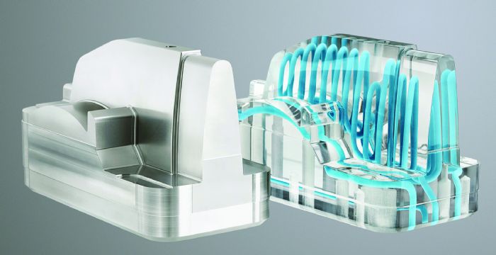

1-Trumpf-Injection-Mold-Insert-additive-manufacturing-LPBF“The benefits of using polymer-AM dies lie within low-volume production such as vehicle prototyping and spare-part manufacturing where the cost of traditional tooling results in high per-piece prices,” the paper reads.

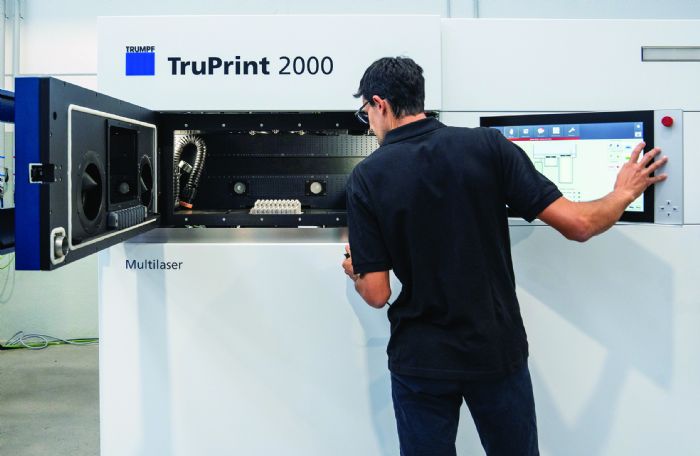

2-Trump-TruPrint-2000-additive-manufacturing-LPBFAs opposed to polymer-AM parts, metal-AM parts likely require post-processing to achieve proper shape and surface finish, adding to tool cost and lead time. Other challenges with PBF- and DED-produced parts include “thermal deformation, processing defects and reduced fracture toughness,” the paper explains. “The thermal deformation results from the scanning heat source locally melting material and allowing it to cool. As each region solidifies, it continues to cool and contract, resulting in thermal stresses that increase as build volume increases. The deformation can be mitigated through design of the component itself and placement of support structures.

Layer-by-layer part construction via LPBF offers big advantages when tools or inserts require conformal cooling channels—traditional machining processes cannot perform such tasks. LPBF also offers the ability to add tool features to dies—no need to print a whole block when machining provides the best option. For its part, Trumpf offers its Preform option on some LPBF systems to support hybrid component construction. Here, component structures to be additively manufactured are applied to an existing block. This means that less printing is required while gaining AM benefits such as component detailing, and simplifying handling in tool and mold making.

Trends in LPBF include larger build envelopes and integration of addition lasers in builds to increase productivity. But these advancements bring challenges.

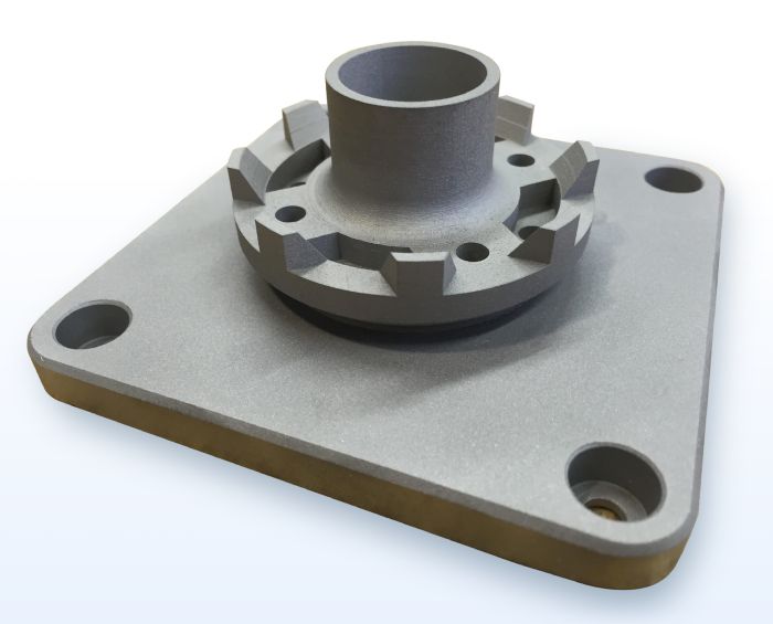

Xometry-metal-am-part-steel“A larger build envelope brings more heat into the system, which, for larger parts, increases the potential for excessive wearing and cracking, depending on the type of tool steel used,” Simons says. “We’ve learned a lot on the machine side for managing parameters and managing heat, and have added more capabilities to machines that enable printing of larger parts.
“Also, the 3D printing industry really needed the ability to employ more than one laser on a single part in larger-format machines,” he continues. “To do that, Trumpf has focused on multilaser-alignment software and ensuring quality in stitching areas (where separate lasers heat adjoining material), and achieving consistent quality overall.”

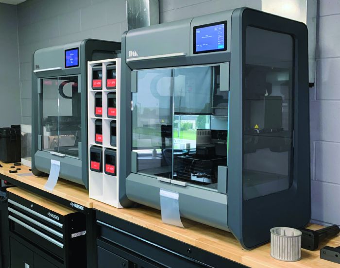

Parts-Egar-Desktop-Metal-Studio-additive-manufacturing-toolingAs for PDF, more than 50 parameters can impact part quality, challenging efforts to develop effective build strategies. That said, PBF provides a unique ability to produce lattice structures and conformal cooling channels with high dimensional accuracy and diminished surface roughness.

Egar-Desktop-Metal-Studio-additive-manufacturing-toolingSpecific to metal AM, LPBF and DED still offer the best manufacturing options for tool building and repair.

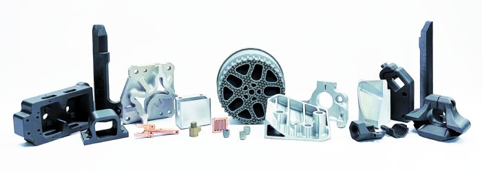

Egar has employed nonmetal AM to produce sensor and lubrication-spray holders that attach to production dies.
“They don’t contact the stamping material or do any work, but these holders—integrated into the tooling—point the sensors and sprayers where they need to be,” Kools says. “We typically print a higher-end material such as ABS, nylon polymer or a reinforced material for these applications.”

As for metal AM, Egar is trialing tooling applications using inhouse Desktop Metal Studio systems. This technology employs FFF featuring bound metal powder as input material as well as sintering. Kools reports very little extra finishing needed on these AM parts. Given the system’s work envelope, considered metal tooling measures no more than the size of a shoe box.
The key in tooling applications: using the least amount of material, not for lightweighting but to save on material costs. Trials include forming and cutting tools.
“We’re developing heat treating procedures to achieve Rockwell hardnesses that can survive production rates,” Kools says, “and focusing on smaller components that are key to the complexity of a produced part. We would CNC-machine a big block, then place an AM piece inside of that block, providing the needed complexity in that small area of the die.”
Egar employs AutoForm simulation software for their Sheet metal simulations and combines that with sintering-simulation software in developing and trialing the AM/machined tooling.
