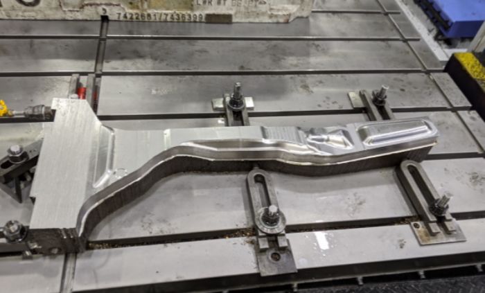

Wire-fed AM for production of hot stamping tooling has progressed beyond what DTG and ORNL had researched earlier—collaboration between the two has since ended—as outlined by ORNL officials in a presentation last fall at MetalForming’s Hot Stamping Experience and Tech Tour. In a recent collaboration with Dienamic Tooling Systems, ORNL touted improved cooling effects and reduced lead time in AM test tooling, specifically a 400-lb. 5-ft.-long full-scale automotive B-pillar hot stamping die, as compared to a fully machined tool with machined channels. Three days of printing, using Type 410 stainless steel toward the exterior with a mild-steel core, followed by finish-machining, yielded the tool. Using AM, ORNL officials cited tool-build lead reduction from 20 days down to eight with 20-percent cooling improvement in selected tool regions, owing to optimized sizing and routing of cooling channels not possible via machining alone. Austin acknowledges this improvement and is keeping a close eye on the wire-fed process for hot stamping tooling, but still has reservations, namely in residual stresses and deposition rates.

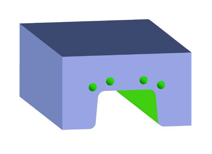

2a-DTG-ORNL-CAD-Model-Upper-Hat-Die“When we evaluated wire-fed AM, we concluded that, for management of residual stress, we needed to be able to map those stresses in advance,” he says. “I know that ORNL has done some collaborative work in mapping residual stresses to predict where stress is created.”
With such knowledge, according to Austin, a tool can be printed on a two-axis rotating table that allows for stress placement in a plane perpendicular to loads to reduce delamination, cracking or other failure modes.

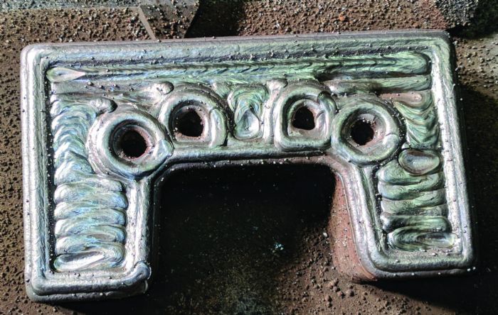

2b-DTG-ORNL-Upper-Hat-Die-Wire-Fed-AM“With shrinkage compensated for (as the tool cools after deposition and heat treatment),” he says, “such a tool would be capable of withstanding typical impact loads and thermal shock loads found in the hot stamping tooling business. But while deposition rates are improving, these rates still are far short of what’s required economically to produce large-scale tools.”
While Austin also sees R&D improvements that allow for viable printing of conformal-cooling tool segments, “cross-drilling will be cheaper for the balance of a tool that features somewhat straight holes in the channels.”
