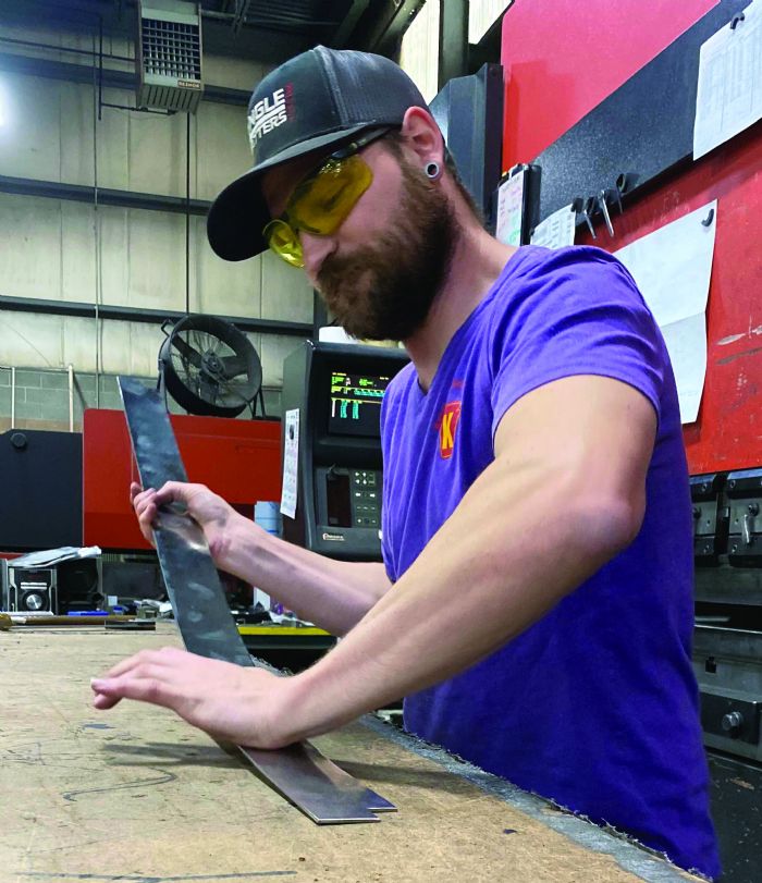

The operator must work the deformed material flat before forming it, either through hand manipulation or rolling. If the deformation occurs in multiple directions, such as a simultaneous bow and a twist, don’t try to work the deformation out from multiple directions at once. Instead, work one direction first before moving on to the other.
A cost-effective way to remove the twisting is to press the twisted part against a jig made of wood or a set of flattening dies.

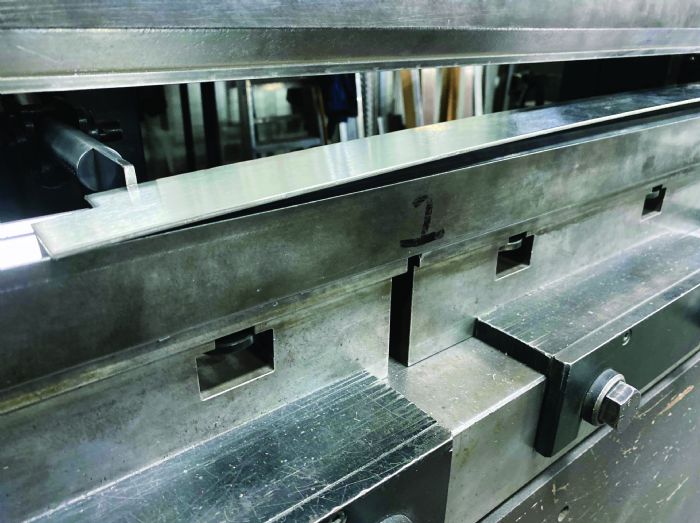

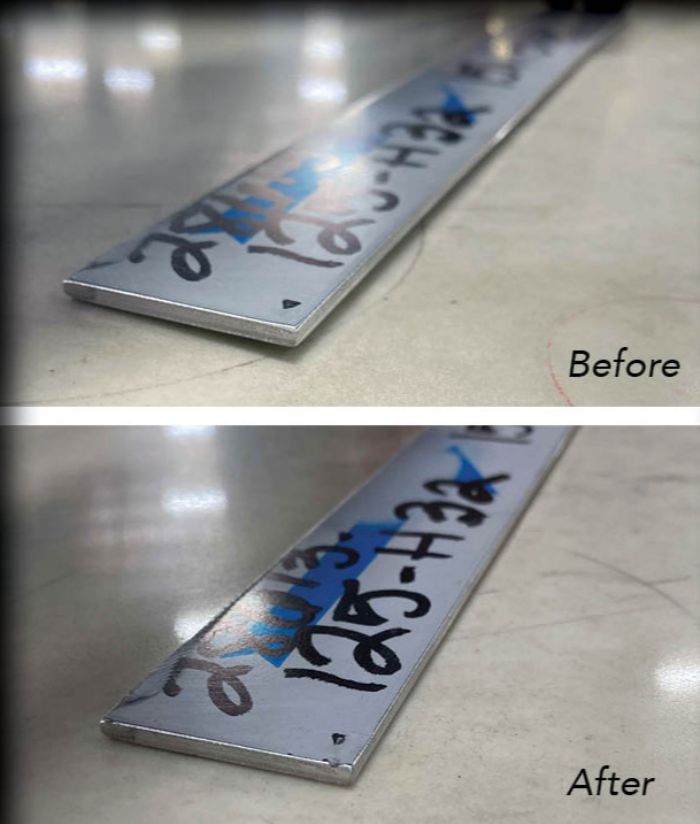

Fixing Long-Strip Bow
Typically, backgauges have two fingers, or stops. An operator moves these stops out to the farthest edges of a part to gain optimal rigidity during gauging. But forming long strips such as framing channels can present challenges. Often, the material is thin and the wide spread between the stops presents a ripe opportunity for an operator to press too firmly, bowing the workpiece. The bend line itself remains straight but the resulting bow in the workpiece will manifest in the flange as a tall center, only tapering down to the correct dimension at the stop location.
To remedy this, you might simply add a third stop in the center. That equalizes the gauging pressure across the workpiece, right? Almost. Any bow in the blanks can still present a gauging issue. A blank bowed away from the center stop only requires some extra pressure in the center to touch. But a blank bowed toward the center will touch the stop early, pushing one of the end stops away. Depending on part length, this now may become a two-person operation to ensure that both ends and center are held against the stops.

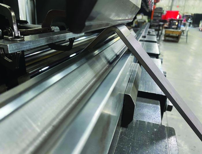

Fixing Overbent Angles
Run a brake long enough and you are sure to overbend an angle. It happens. Depending on machine and tooling geometry, overbending may not be a big deal. You may simply be able to flip the part over and unbend it manually. Note that this cannot be done if the power flowing through the machine and the part are offset, such as with 2V dies. If that’s the case, flipping the part may result in part slippage and personal injury.
Using an upside-down large-radius punch and mallet will correct the overbend. This creative approach requires some blood, sweat and tears, but prevents the signature dent on the outer edge.
The outermost edge forms from the initial bend, so when the punch contacts the outside radius, it will leave a signature dimple.
Often, sliding witness marks appear on the inside radius from the lower die at the contact point of the radius. Reduce these marks using brake die film.
The last, desperate but sometimes effective method to correct an overbend is to knock the part on the table. Sometimes all you need to do in order to adjust for a little material variation on a long run is a quick whack. As silly as it sounds, a quick tap on the outside radius of a firm surface can sufficiently move the angle of a flange.

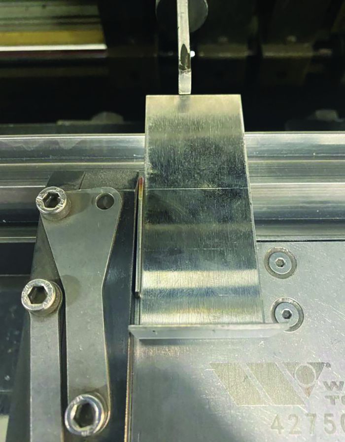

Fixing Side Blowout
A side stop or side gauge keeps short-bend-length parts perpendicular (or otherwise) to the bend line. Watch for material-edge deformation on successive bends. Blowout on the side of a bend may occur at the point of contact between the workpiece and the side stop. The effect is a perpendicular first bend and a slightly out-of-square second bend.
A quick remedy to mitigate side-stop blowout is to stack another square bar against the side stop.
