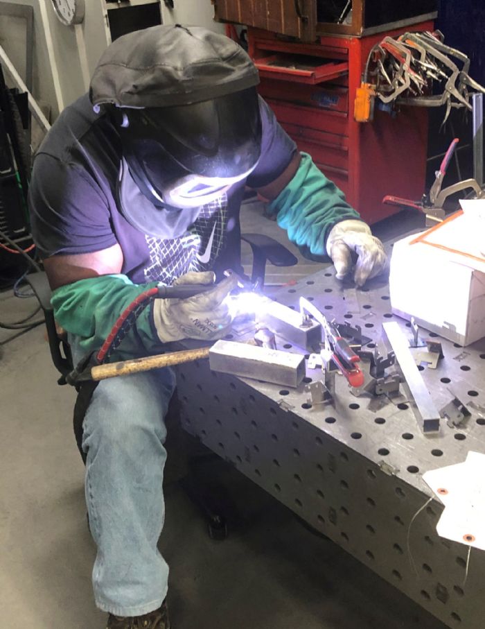

decimet-rapid-response-cell-gas-tungsten-arc-weldingDSI historically has focused much of its metal-fabrication work on supplying retail display racks and the like for in-store product marketing. Its customers work with marketing firms who in turn work with the product suppliers and retail outlets to constantly update and refine their displays. That constant churn in product design keeps DSI on its toes, as it’s often asked to iterate prototypes several times within a short period of time.

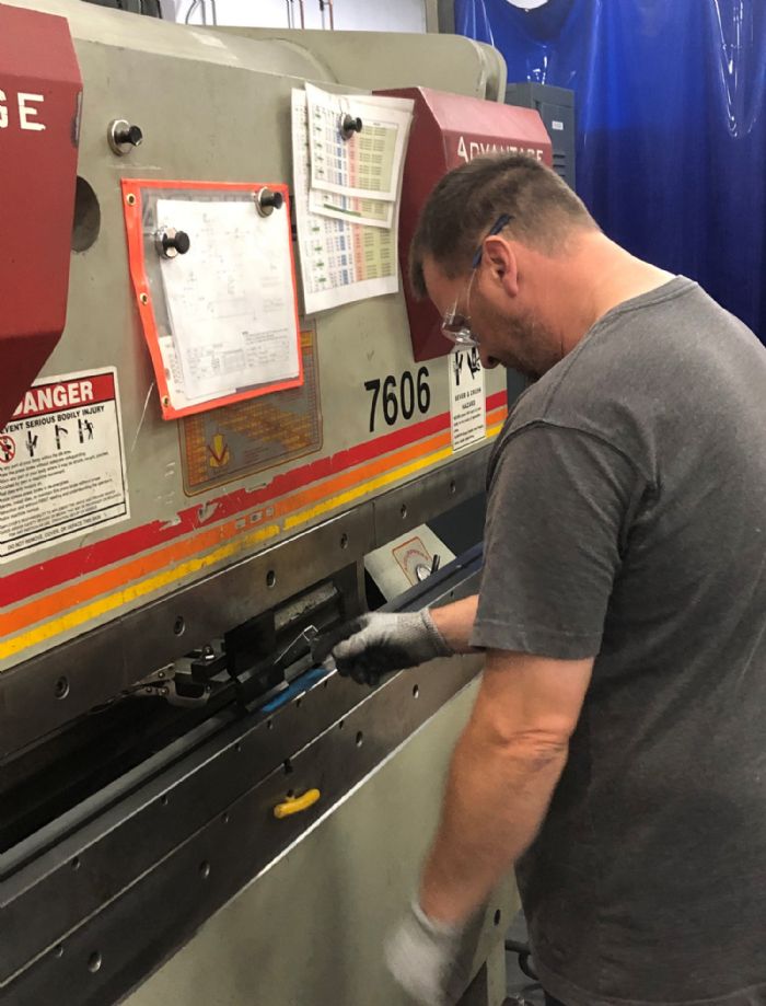

  • AccuPress Model 7606
    • 60-ton, 6-ft. press brake with Advantage package designed for off-center and stage-bending applications

DSI fabricates primarily 16-gauge mild-steel sheet, covering the range from 20 gauge to as thick as ½ in. And, notes Horn, it’s seen an increase in the use of aluminum extrusions. Tolerances fall into the 0.015- to 0.030-in. range, “requiring us to fine-tune our press-brake process especially on parts with multiple bends.”
Helping along those lines is the firm’s new Amada HRB 1003ATC press brake with state-of-the-art bend-angle compensation technology—not part of the RRC but called on when jobs require it.
“It’s the coolest press brake I’ve ever seen,” Horn says. “It double-checks the bend angle and makes adjustments as required. And, of course, in production they appreciate the automatic tool changer to achieve fast setups to optimize machine green-light time.”

One enabler of such a decrease in lead times: recent addition of a Certiflat FabBlock welding-fixture table (from weldingtables.com), 4 by 8 ft. and 3⁄8 in. thick, with a 16-mm hole pattern to hold clamps and tooling.
“This table eliminated a lot of the time required to fixture our welding jobs,” says Horn, “and we can fit several weldments on the table at one time so that the welder optimizes his arc-on time. It’s added quite a bit of value to the RRC. The next addition to the cell will be bar coding.” MF
