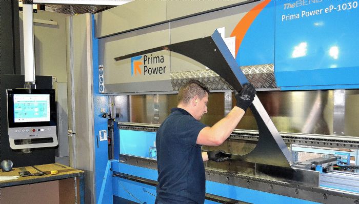

“So, when it comes to ensuring quality on the shop floor, the performance of a newer press brake is not the deciding factor. When it comes to accuracy and repeatability,” says Croft, “you have to appreciate and control the entire process—critical variables such as consistency of the workpiece material (thickness, mechanical properties and grain direction, for example) and the quality of the tooling.”

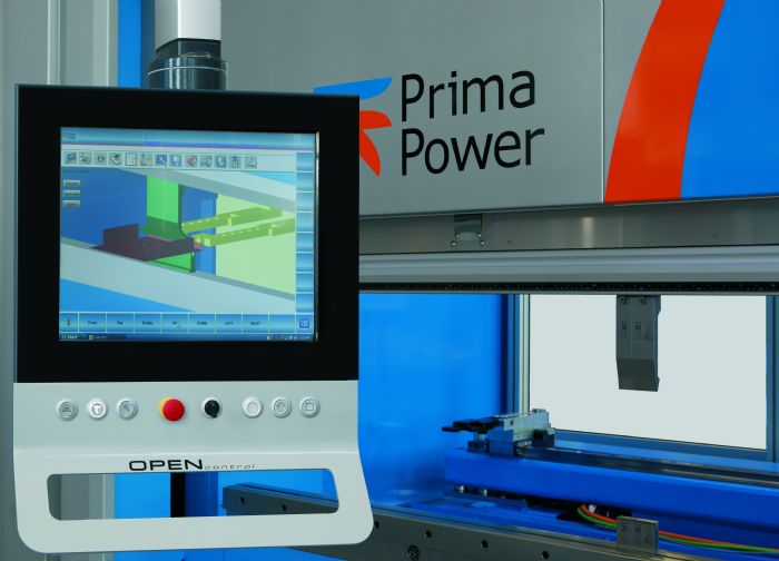

B prima power press brake control bending simulation“The machines themselves have evolved to become very user-friendly interfaces for the operators, and as long as fabricators invest in good, precision-ground tooling, the brakes will perform as designed,” he says. “When we do see inconsistency in bend accuracy and repeatability, often it’s due to material-thickness variation throughout a stack of blanks. Even a difference of just a few thousandths of an inch in thickness can cause a 2 or 3-deg. variation in bend angle.”
To adapt for material variability, in nearly every case when bending mild steel or even galvanized material, the simplest, most affordable—and reliable—solution is to affix a thickness-measurement gauge to the press brake. “We then can measure the material thickness as part of the bending process, and adjust the depth of the ram penetration into the die to achieve the desired bend angle,” says Croft. “Often there’s no need to adopt the more expensive optical-gauging systems, based on laser-measuring technology, which require a more time-consuming bend, measure and rebend process. With the thickness gauge, we feel like we’re fixing the problem before it even appears.”

He has a suggestion for solving this disconnect: Provide the design team with a seat of offline programming (OLP) software that will allow for simulating the bending operations and verifying programmability of the part designs, before they ever reach the plant floor.
“OLP software contains all of the modeling for the press brakes and tooling on the floor,” he explains. “So, if the designers can’t develop a process in the design studio to form the parts, they need to go back to drawing board and redesign the parts until they can simulate a successful bending process.

“With these press brake tools,” he explains, “we’re really talking about controlling two critical dimensions: the height of the tool (or the tip location), and the precise machining of the groove that’s ground into the tang of the tools. When the operator installs the tools in the ram and then activates the hydraulic clamping system, a perfect bend line results, across the entire tool set. That’s all the fabricator needs to see—no more concerns with the tool being offline on one side of the brake versus the other, or having to flip the tool around to get it to align properly. The result: improved bend accuracy and quality, and faster setups.”
