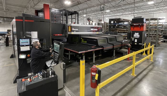

“The Acies is the star, for sure,” says Lefeber, adding to Zanardo’s comments. “The cutting speed of the fiber laser allowed us to replace three aging, stand-alone CO2 laser-cutting machines and not miss a beat. The automation featured on the Acies—including sheet loading and unloading, parts separation, automatic punch-tool changing and shimming, and automated lens cleaning—contribute to near-zero setup time and optimum productivity. When you’re a high-mix low- to medium-volume shop, setup-time reduction is a critical success factor.”
Sheet material for the Acies automatically feeds from a six-shelf storage rack (three shelves for raw material and three for cut nests), which MPE stocks with material each evening to enable 6 hr. of lights-out cutting. A seventh shelf in the rack holds sheet skeletons after parts have been separated.

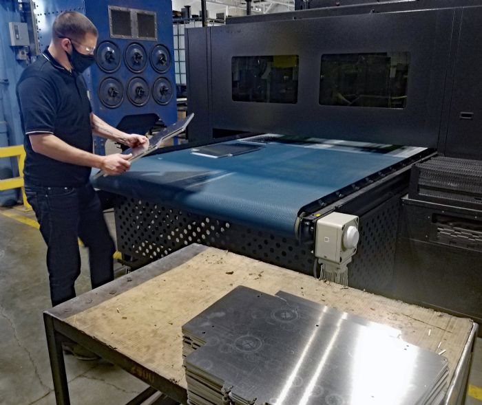

Of particular benefit, Lefeber says, is the optional rear conveyor on the Acies, which can direct parts directly from the punch-laser to the prototype cell. “The automation can pick parts as needed from the nest,” he explains, “and place them on the conveyor to send them on their way to the cell.”

To streamline assembly, MPE relies on its cutting machines to perform a great deal of in-process tapping, and the Acies’ multipurpose turret delivers. It features four tapping stations, and provides automated hit counts to signal the need to replace a worn tap with a spare. The machine controller also can detect broken taps and immediately stop the machine.
On the punching front, while the Acies’ fiber-laser source enables cutting of most holes and other cutouts, in addition to part peripheries, MPE’s punch-tooling library gets the call for forming 3D features in parts—bridges, lances, extrusions and the like. MPE has some 100 punch tools in its library, including several recently added duplicates of its biggest runners. The storage rack automatically transfers tools to a buffer turret while the machine runs, queuing tools for the next job on the schedule. It also holds as many as seven tapping tools that can be rotated into the four tapping stations in the main turret.
“We also appreciate the machine controller’s ability to store the height of each punch and die after they’ve been ground,” says Lefeber, noting that it has serialized all of its punch tools for tracking purposes. “Using a QR code on each tool and an RFID scanner, the machine auto-shims the tooling, which can be a painstaking manual process requiring a great deal of operator skill.  In addition, the machine will kick out tools when they’ve reached their programmed number of hits.”
