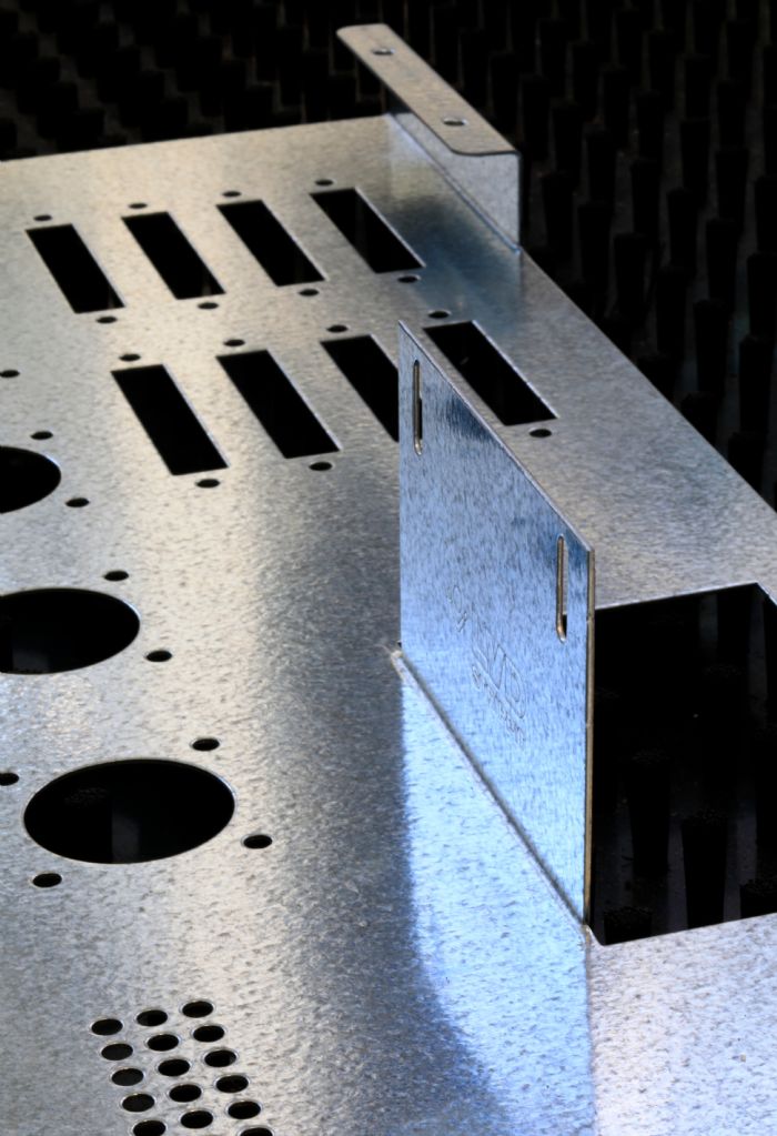

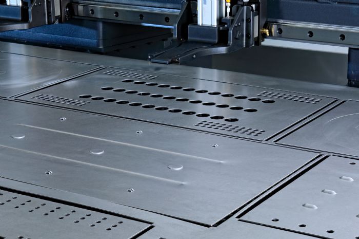

Micro-joints seem simple enough, as most programming software includes a default for either a material-thickness percentage or a set value. However, the size of the micro-joints must change depending on the material used—a variable for which programming software does not compensate. What works for mild steel differs from that used for aluminum or higher-tensile materials such as stainless steel. The material type and thickness, and the number of joints, all factor into determining the proper size of a micro-joint. For instance, thin material will require thinner micro-joints. If you place a thick or large micro-joint on thin material, it will take more effort to release the parts from the skeleton. The most efficient micro-joint will keep a strong enough bond to the sheet to keep the part stable during processing, but then break cleanly with a shake of the sheet without requiring a secondary operation for part cleanup.
If the micro-joint is not properly programmed and the interconnecting tabs do not remain intact or do not allow for simple part separation, ramifications could include having to stop the machine to remove loose parts from the table, or using a screwdriver or other tool to manually break out the parts. The latter could deform the parts and potentially add cleanup in the form of a secondary operation.
What if you’re using a four-way radius tool on the corners of a part and need micro-joints along the length of its sides? Placing a straight micro-joint on the part will require a secondary operation to either file or grind off the nub. A better solution: Use a micro-joint tool or bowtie tool. Used properly, this will provide a breakoff just underneath the surface of the part.

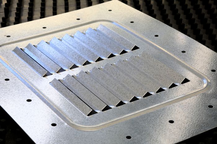

Forms tools can present programming challenges. Form dies usually are taller—sometimes significantly taller—than standard cutting dies simply due to the action they must perform. This is especially true of form-up tools such as lances, louvers and hinges. The die height matches that of the form to be produced. Form dies sit above the die shoe, while standard cutting tools sit more or less flush with the die shoe. Because of their height, form tools have a greater risk of colliding with the workpiece material, or causing other issues such as part distortion or breaking micro-joints. Poorly planning the positioning of higher form dies undoubtedly will result in negative consequences.
