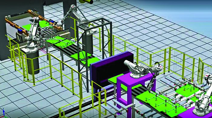

dual robot centeringWant to run faster? That’s where gantry setups shine. “These simple two-axis gantry motion systems can allow a transfer press to top out at 30 strokes/min. or more,” Stirrett says, noting that instead of a vision system to orient the blanks coming from the stack, “we either ensure that the blank stack is set up as required on the handling system, or use vision and other dedicated equipment to identify and adjust each blank to present it to the transfer tooling. These setups include a physical mechanism able to stop the blank as it feeds on a conveyor and crowd it into position using a series of independently adjustable pins.”
Gantry setups, often custom developed for the application, are T-style (with blanks moving from stacks perpendicular to the feed direction, then turning 90 deg. to feed into the press) or inline. They use an overhead pick-and-place mechanism to move blanks from one or two stacks onto a shuttle, an infeed conveyor, or idle nest system for delivery to the press. One feed head serving one blank stack can feed at stroke rates in the mid-20s, Stirrett says, and faster by adding a second feed head.
When do metal formers opt for vision-guided robotics to feed blanks vs gantry systems? “Robots often are commodities, especially for larger OEM and Tier One stampers,” Stirrett says, “and come in at a lower cost than a custom-engineered gantry setup. And, the cost of vision systems has dropped as well, becoming very cost competitive. There even are cases where we propose the use of vision systems with gantry systems.
“When we know an application will include a destacker,” Stirrett continues, “we look at the geometry around the press—do we have enough room for robotics, because these setups can take up considerably more floor space than a gantry system. We also look at what the customer is most familiar with—if a company has a lot of experience with robotics, such as the OEMs, we tend to stick with that approach. But we also look at speed, and again this is where a custom-engineered gantry setup shines; we can dial these up, based, of course, on press capacity. If the press can only run a job at 16 strokes/min., robotics will suffice, and a gantry will be overkill.”
